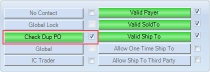

If this field on the customer is not checked you can.

I just checked and it is ticked for that customer. This particular customer is an intercompany customer too, should that make any difference?

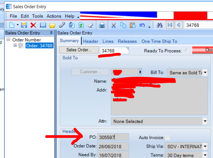

Umm, Mark those are two different SO#'s in your screen shots. :wink:

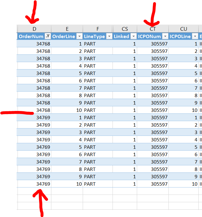

For the 2 orders the orderDtl table shows the following…so yes all the same.
My gut feeling at this point is like the previous post said…the duplicate POs may have been unticked behind the customer…then reticked after the order has been put on.
