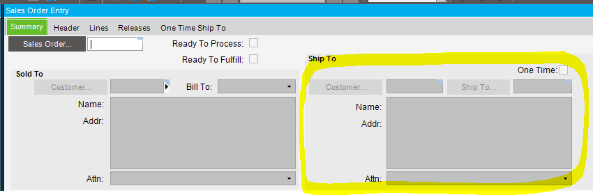

Sales Order Header Ship To field
On the Sales Order screen, there is a Ship To section in the summary and header.

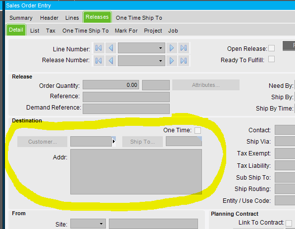

However, we’re not seeing that this field affects anything; it doesn’t go onto SOA or pack slip.
That in order to ship an order somewhere else, we have to go to each Sales Order Release and change the Destination there. That is what shows up on the SOA and pack slip.
Destination doesn’t auto-update OOTB, and there is nothing in help that I can see…

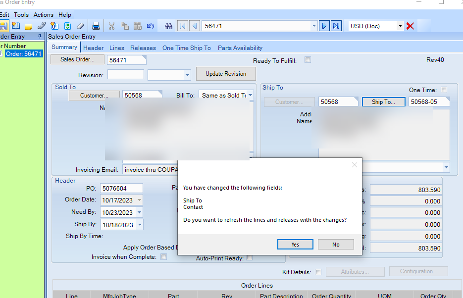

Hi Terry,

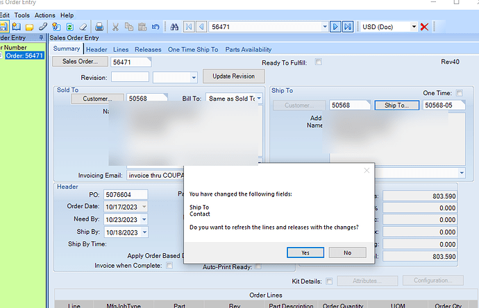

Our does this… .IDK why yours would not. This is a ship to address change on an order with several lines.
Nancy
Good call, Nancy! I thought you maybe had a directive triggering that, but it works on my side too. Just click shipto to change the header level shipto, then save the sales order and you get that popup to fix the rest of the lines. Cool!

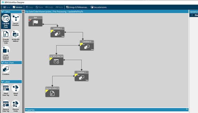

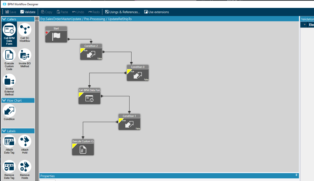

OrderRelShipToUpdate.bpm (44.6 KB)
This attached a BPM should replicate that pop-up that you’re missing. I left notes on each widget to explain what it’s doing. Should be pretty straightforward.
I’m not 100% on the last widget custom code. @klincecum might be able to check my work, the code is below:
// This is the bit I'm not sure of. Does the ds.OrderRel have any rows if only the header has an updated field? If not, you might need to use the commented line below instead.
var AllRels = ds.OrderRel.Where( x => x.OrderNum == iOrderNum );
//var AllRels = ds.OrderRel.Where( x => x.OrderNum == iOrderNum );
if ( AllRels == null || AllRels.Count() <= 0 ) return;
string newShipTo = ds.OrderHed.FirstOrDefault( x => x.Updated() ).ShipToNum;
foreach ( var Rel in AllRels )
  Rel.ShipToNum = newShipTo;

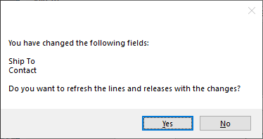

Ok I got to bottom of it. User error.
Issue was that when we change the ship to in the classic form, it doesn’t take until you hit the save button. Even though it looks like it did, like all other fields. So when I tested it in the live environment, I didn’t know I needed to hit save, hence no dialog. And then @NateS sent me down a rabbit hole lol.

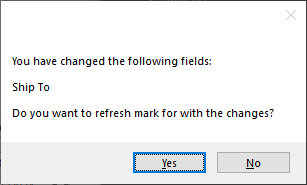

I’m pretty sure they were asked to “refresh the releases”, but they said no. In their defense, the words in the dialog aren’t clear.
It should say “change the destination for all releases”.
And then there is this word salad…
