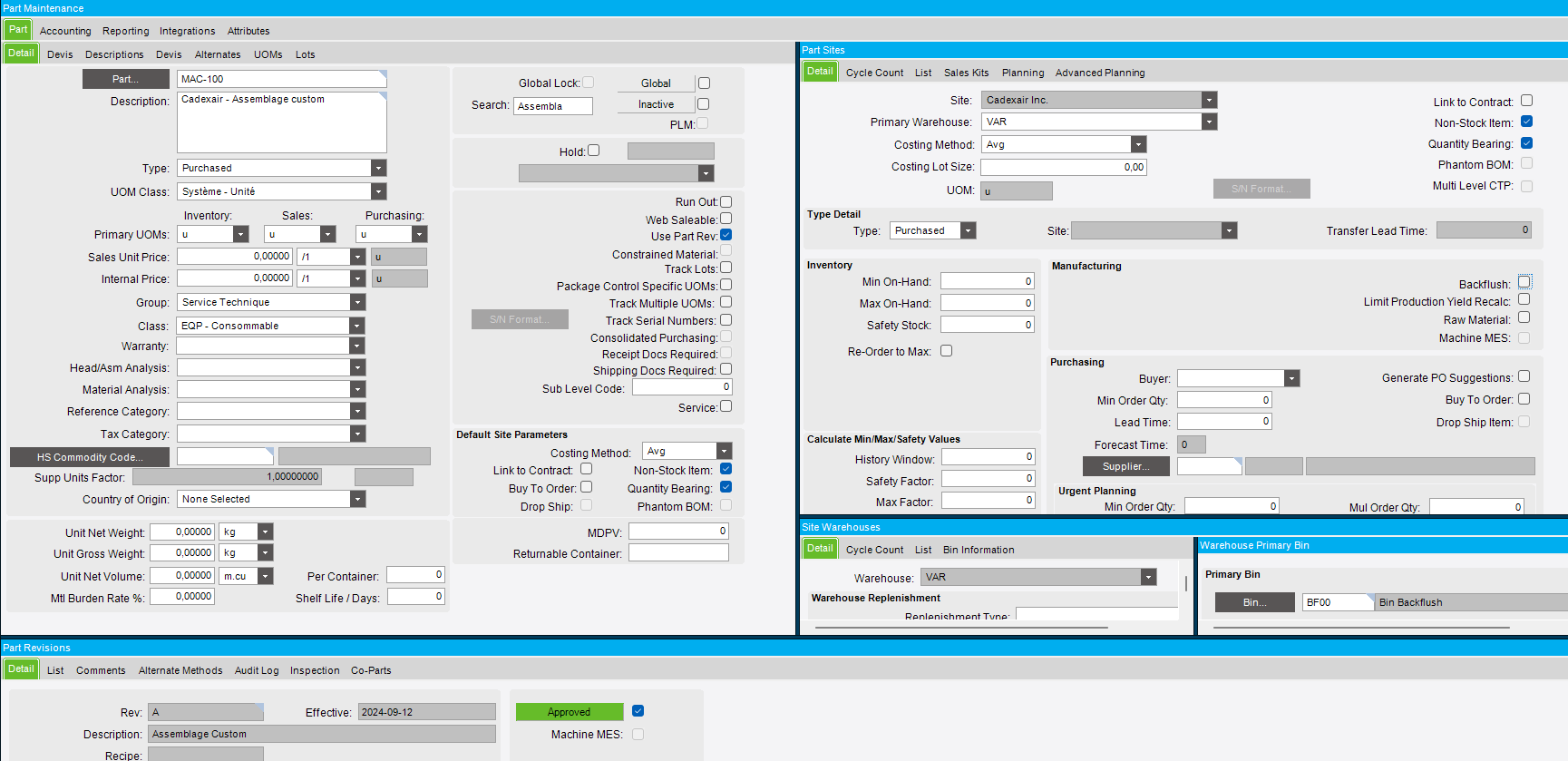

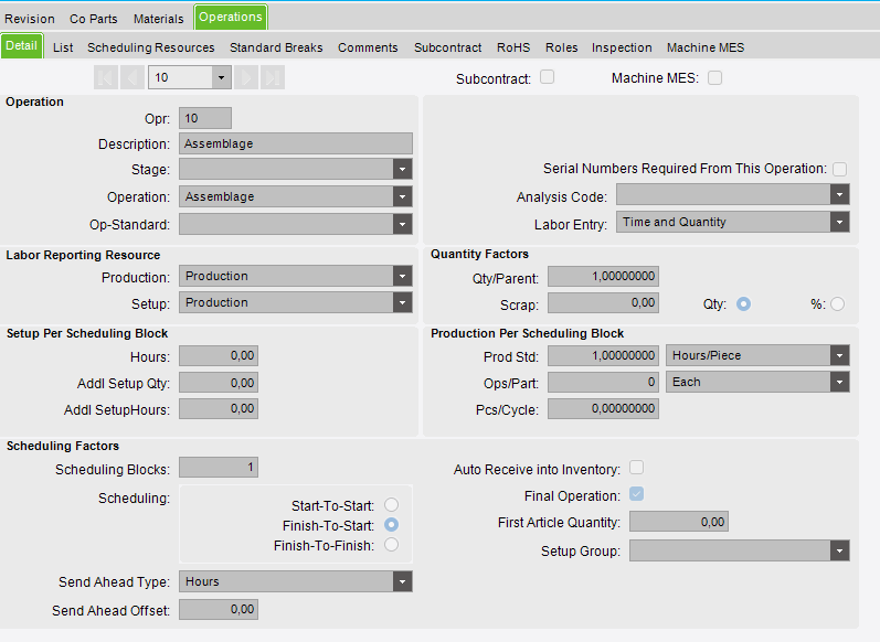

Yup, that too, setup like the other parts. I tried a few things with the QTY bearing checkbox and backflush as well, no default bin, added a backflush bin
Here are screenshots, maybe you can catch something I don’t.
Do you have more than one site?
Is the Buy To Order box checked on the SO that part is set up as Purchased.
Did not drink enough coffee… one of the first box I setup everytime lol… Now I know what I forgot here an there.
Tested and works now. Thank you!!
