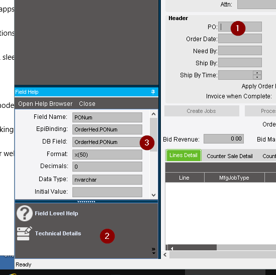

If you see a field on a form, the best way to find it’s source is to use Help -> Field Help.
  1. Give focus to the control that you want the details for (even read only controls)
  2. Click Technical Details in the Field help pane
  3. The DB field is show
Then in the pane that pops up, select the Technical details.
