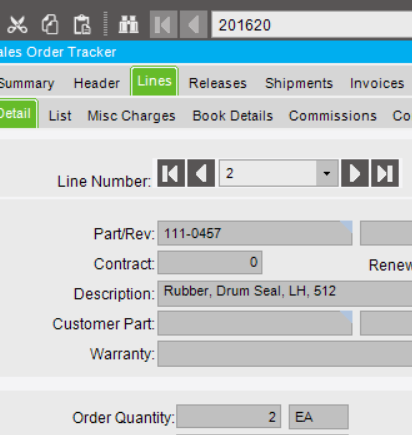

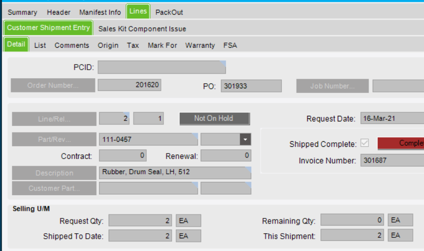

Order 201620 for 2x 111-0457 has a closed & invoiced pack for the correct amount yet SO line remains open. All done 3 months ago so can’t delete invoice etc:
Any pointers?
Any pointers?

Happens to us sometimes. You can just close the sales order if everything has shipped.
Hi Matt,
We find this happens sometimes when shippers need to reopen and correct something in shipment and then close again, or someone needs to reopen sales order and correct something and close again. We use audit log on order entry and shipment entry and can see the reason. I agree with Lacey, just close the sales order and it should be fine.

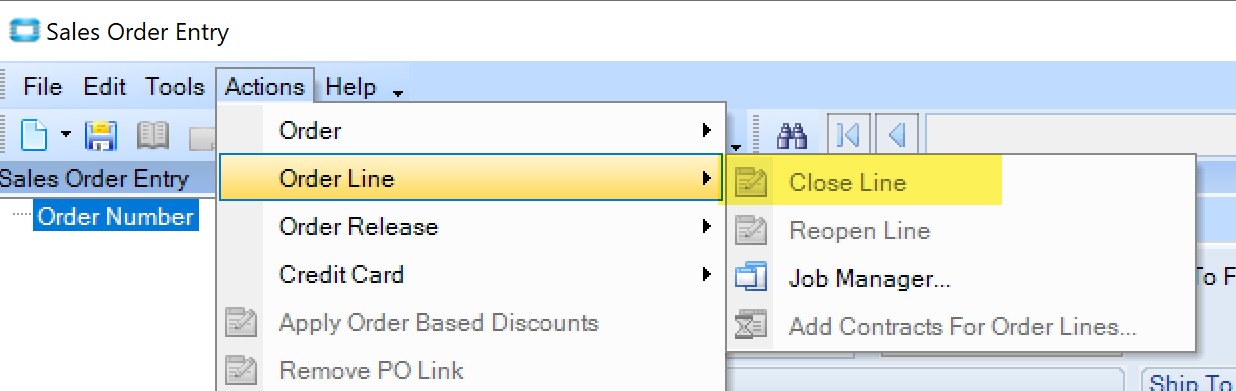

You’re welcome Matt. FYI, you can close the individual line manually (or via DMT) as well, I think I would do this because the order will not close automatically when the rest ships due to the one that open that has shipped. You’ll have to keep checking back on it.
