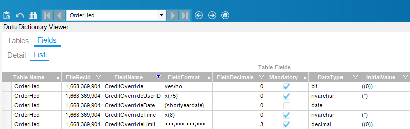

And one can release individual orders but leave the customer on credit hold. You can find those fields in OrderHed:
So, combining what Todd and Mark said, you’ll want to make a calculated field with Customer.CreditHold & ~OrderHed.CreditOverride (credit hold AND NOT credit override) or equivalent logic. (I actually have exactly this on a dashboard, myself.)
