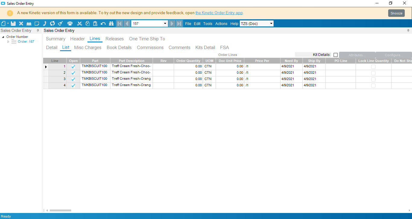

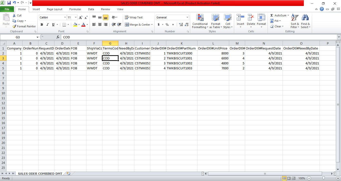

Hi,
We are using a combined Sales Order (SO) template to upload SO.
All fields get updated via the DMT file except unit price for each item.
Is there a reason for this? is there a work around for this?
Please assist. Screenshots attached below.

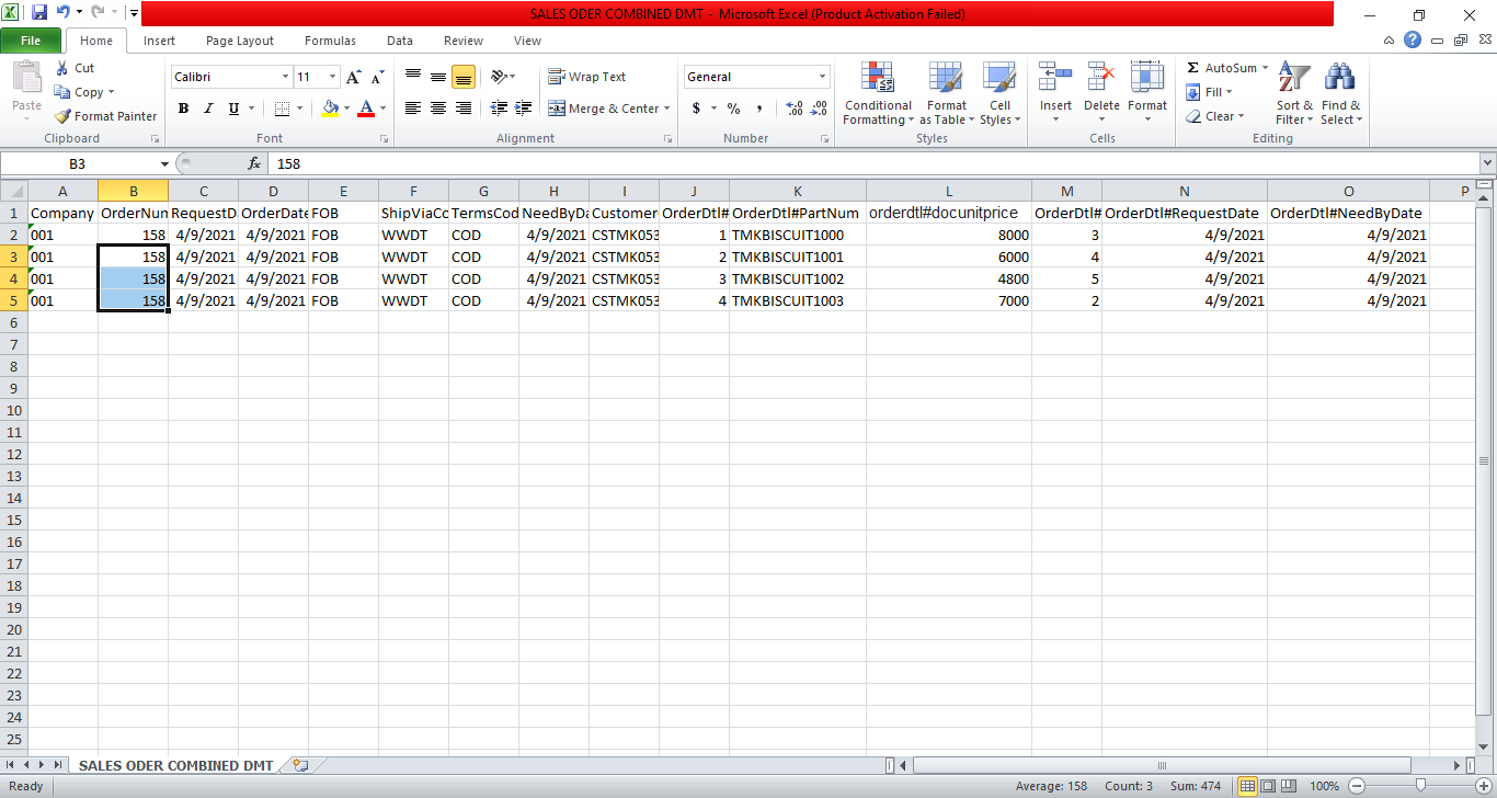

Add column ‘DocUnitPrice’ and try again.

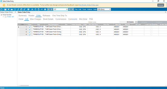

@fakhruddin thank you, we tried to add the DocUnitPrice column but still fails.
We are also not able to upload the Qty field.

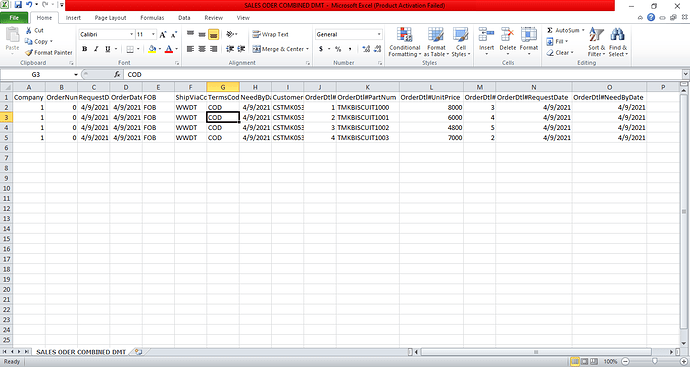

Hi,
Try some ways:
  • Add column CurrencyCode on OrderHed.
  • Check logic of pricing for this customer. Check what Price List the system gets after you import. Or validate price list.
  • Try to add column OrderDtl#LockPrice = true for fixed unit price.

Add OrderDtl#LockPrice to your DMT template and set it to true.
