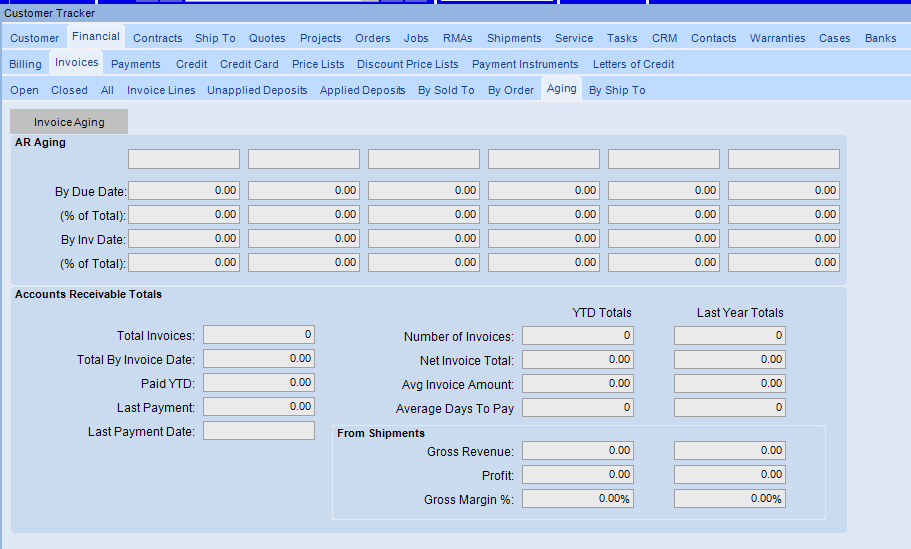

Take a look at the Aging Tab on the customer tracker. One of the best screens in Epicor and it could not be hidden any deeper. For you, it shows the YTD totals and compares last year.
