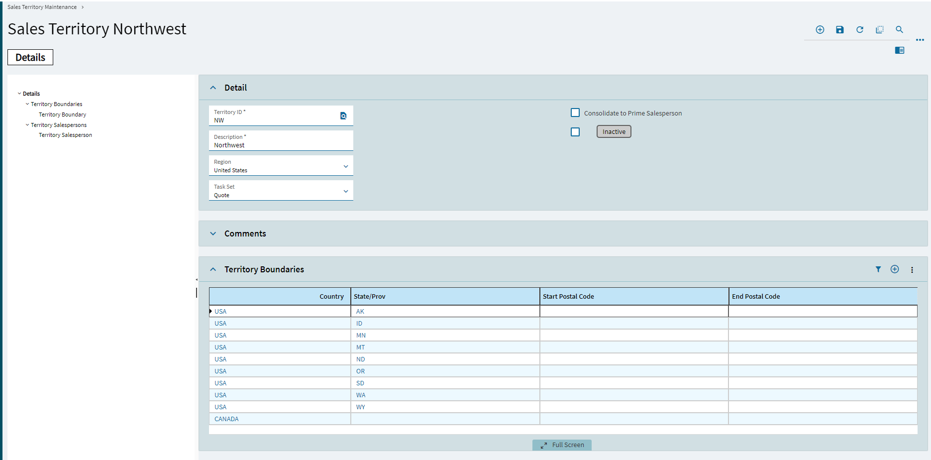

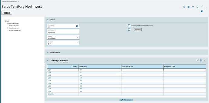

We do not have ours setup by post code but instead our territories contain multiple states. If I use the get territory button it will select the correct territory (Northeast, Northwest, Southeast, and Southwest) and assign the proper salesperson for that region.
Here is what our territory boundaries look like.

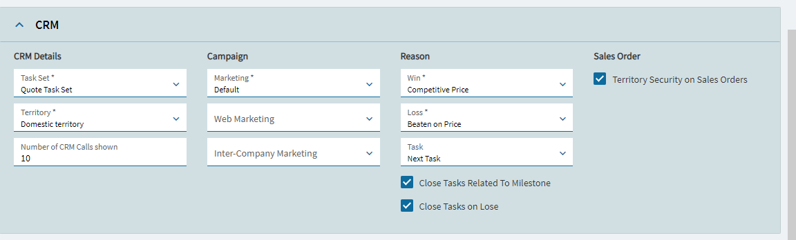

Hi David,

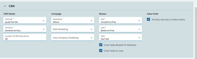

Hmmm similar to us i guess but its not pulling correctly. It always seems to just pull the territory from “default” that is set in CRM section of company config - see below. Any ideas?

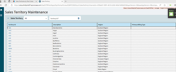

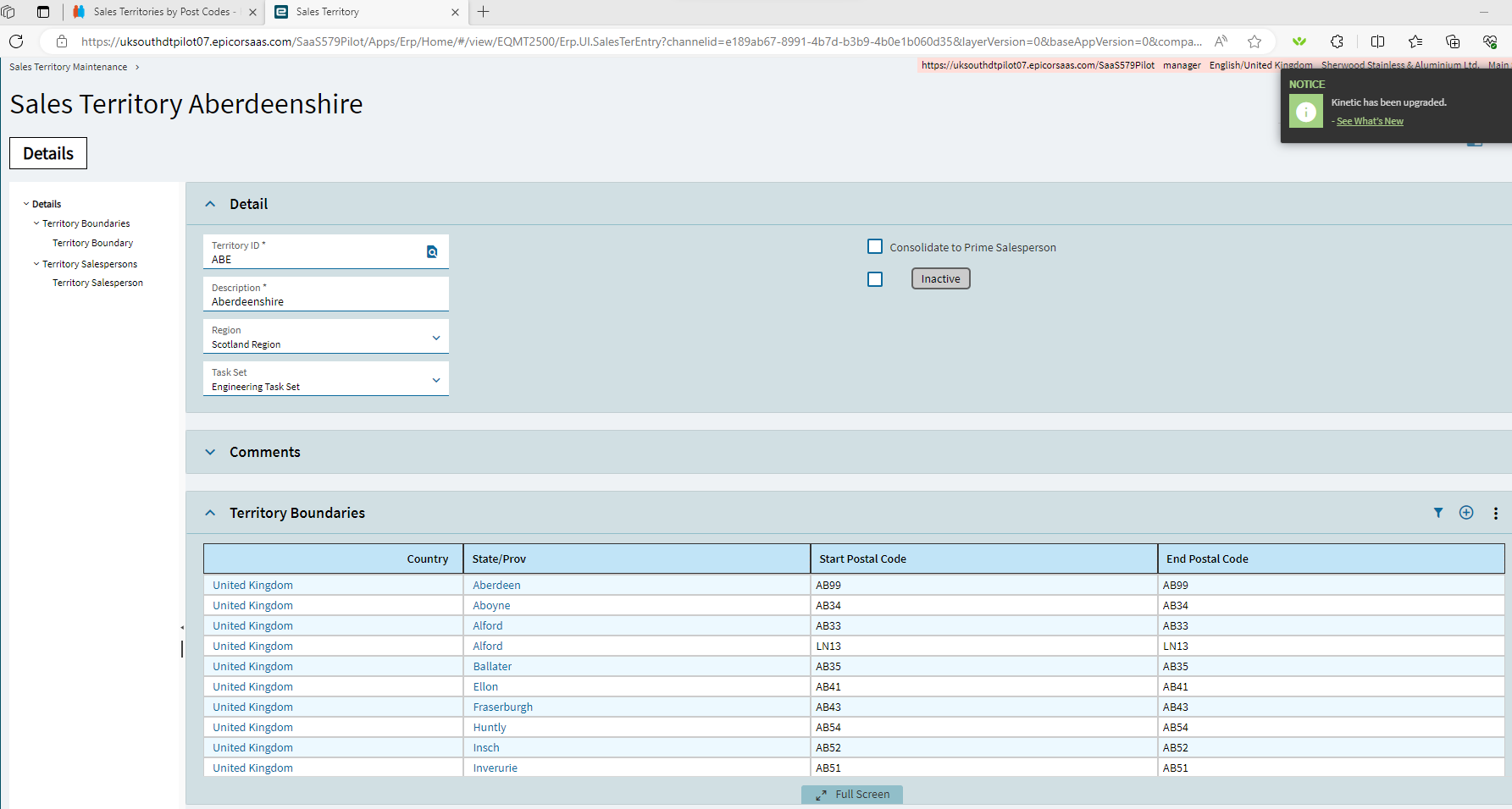

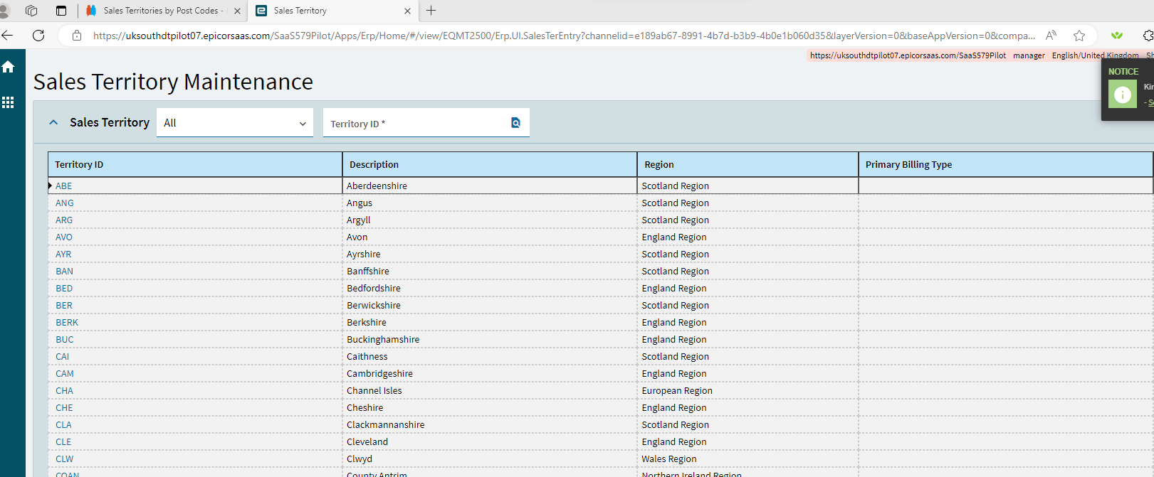

Post us an image of what your Sales Territory setup looks like for post codes, similar to the above image from David - we’ll see if we can’t identify the gap.

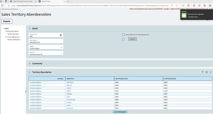

Hi Mark,
This is what the territories/boundaries look like
then every sales person is added into every territory (as any sales person could be on any territory, the sales person is set per customer - not by territory.) The territory would just be used for reporting to identify which areas of the country we are selling in.
