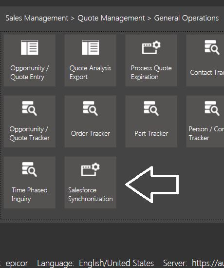

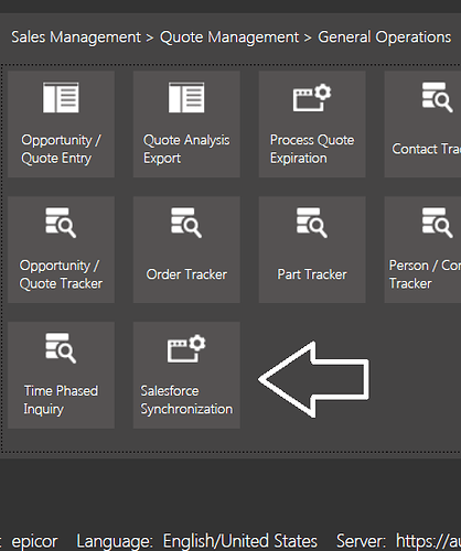

Epicor has a function to connect to an external CRM via a URL.
Jitterbit is used for data import and export. Are you thinking about
adding user defined fields from SFDC to your Epicor tables?
Doesn’t look like that feature is available in 10.1.500.
We’re looking to have SalesForce implemented before we will be going to 10.1.600.
I’ve heard the salesforce integration is enhanced in 10.2, waiting for details.
