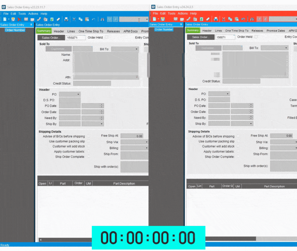

I think you may be on the right track there. Filtering the [U]BAQ to only return the relevant results (Releases attached to the selected line) would filter it on the server side, only sending the relevant results to the client. That would dramatically speed up the process (loading 400 releases instead of 12,000 releases).
Okay - this might be something I can get behind. That is, if I can find time to work on it.
That’s the cool thing about the Kinetic panel cards with grids, you can get rid of the default one and then replace it with your own, bound to a trans view of your UBAQ and they made it so much more approachable IMO as a novice developer.
Update: This issue has been passed along to and accepted by the Development Team as Problem ID: PB0279399

They have eluded to this a few days ago, but now they just flat out said it…And I don’t know if I should be insulted, irritated, or impressed with this response :
To be honest, even if they do fix it, I think I would rethink how you do this as a business process. You may come to the same conclusion and process in the end, but on it’s face, 12,000 releases for one sales order sounds absurd.
Not saying you should change it, but at least game it out.
I agree 100% - It is our customer that does not agree. They have been using the same PO for years (like 5+ years) and they just keep adding more and more releases to it. I have told the CSR team here that this same issue is going to happen again and again, and they (the CSR’s) are going to have to continually split things off into a new SO once the number of releases starts to grow again.

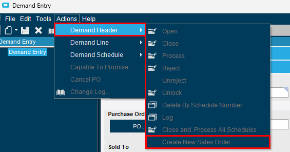

There is an option in Demand Entry of “Create New Sales Order”.
This will close the associated Sales Order, Lines, and Releases and open a new Sales Order using the same Customer PO Number as the initial Sales Order. The only downfall is that any existing demand that was in the old Sales Order will need to be entered into the new Sales Order. This can be done via DMT or by creating an EDI app file and importing that using the “Import EDI Process” screen.
When I split off this Sales Order into a new one a few weeks ago, we had to be sure that the new Sales Order had all of the lines in it that the original sales order had, plus any releases that were due to ship out in the next 2 days. So we opted to take the route of creating our own .app file and importing it into the system.
All of the stress was worth it though. Once that new Sales Order was created using Demand Entry, everything started to work smoothly. There are still the occasional warnings for that PO (shipping dates and such) but nothing that is considered out of the norm.
