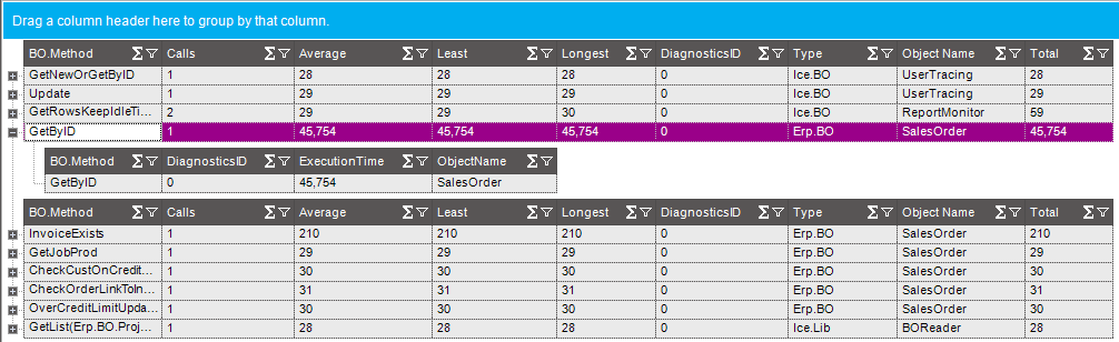

With that knowledge, I decided to poke around a bit more and ran PDT. Upon looking at the ‘Server Diagnostics > Summary Analysis’ tab, I saw this:
That is mirrored in a Client Trace Analysis as well:
As you can see, the Average Execution Time for SalesOrder.GetByID is 45 seconds, which is right in line with what I am experiencing.
