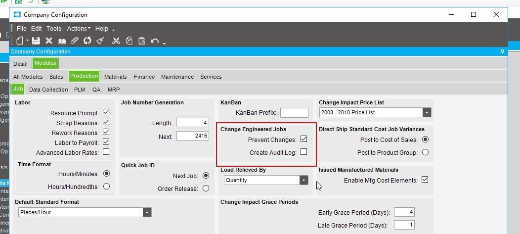

Check this company setting.
Hi Ted,
Yes that is flagged but that is not the issue, that flag is supposed to be checked but you are still allowed to un-release / un-engineer a job. Furthermore it works fine in the customization, just not on the BPM… strange behavior
I’ve had this issue to in the past with BPMs, just wasn’t sure if it was that checkbox causing problems also.

You need to set the Prevent Changes in the Company Configuration (below)

Thanks @Edge
I think that is your delta in the usage.
public static TService GetService(bool ignoreFacade = false) where TService : class
ignoreFacade bypasses BPM firing. By default that is false so no BPM will be fired. (This defaults false so we don’t end up in an endless loop accidentally with a BPM firing itself recursively).
I think you meant the opposite of this, it defaults to ignore=false meaning it will not ignore the facade. I just tried this and by default BPM does fire, if ingorefacade = true then no BPM fires…
Regardless though this isn’t related to the initial issue (I don’t think) of why the code behaves differently from the client side vs the bpm. Any ideas on that?
No clue if both are firing the bpm. I wonder if that logic is doing something with cross services as well. It would take a bit to unravel. Queue up a call if you need it looked into.
I’ve been a little buried in 10.2 efforts in a new role. Don’t have as much free time as previous with the holidays :wink:
No I did them independently, no worries I worked around it for now
Thanks!
PS: New Role? DO TELL
I am running into the same problem. Do we know the cause of the problem?
How did you work around this? I can’t seem to get it at all.
I used BeforeImage.
