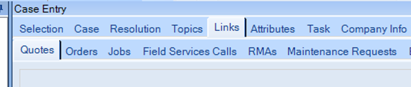

Seems reasonable and doable with a dashboard. We use Case to wrap this kind of data into a reviewable bundle. Quotes to Orders should be clean. Order to jobs there are examples here that I used to make a dashboard that does that. Alerts are not hard and I have a bunch of samples you are welcome to.
One of the lessons I learned after adding a few pairs of held and released checkboxes for 1st Article and source inspection was to make the hold type a user code, so they can have as many as they need without me adding any more fields and I just have a hold and released on the order line that stops the user if the hold is set, but released is not.
Can you make a “Case” for using Cases? I have played with Case entry a little, but it feels very big. I was worried it might be too much for our users, but you are not the first to mention using Cases for this purpose.
I know for one I would need to set up a task set with appropriate tasks, but honestly thats not really a bad thing.

In our former ERP we had a contract review workflow and wanted something similar in Epicor and we studied Case which is really HDCase as in Help Desk Case and Project and settled on Case. It has it own internal search that could be used to find previous orders by a lot of criteria.
I built out sections for Compliance, QA, Engineering, Purchasing and Production Control, so this is the one source for information related to the customer’s order.
We have task sets for new and repeat orders, internal and external ECOs, expediate and cancel orders, customer issues, and RMAs.
