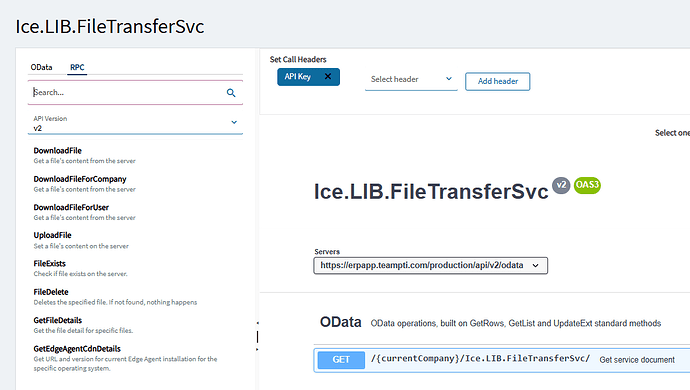

Instead of granting write access to various folder locations from your Task Agent windows account, and pushing files everywhere, you could use PowerShell for your Epicor automations to pull files to those folders using REST and the FileTransferSvc:
One could use this method to place the file in a folder, in the cloud, etc. This would be even easier with the addition of Webhooks to Kinetic, especially since Data Directives on SysTask have been (temporarily) disabled. Not sure if CDC works with SysTask or not… ![]()
Interesting, I’ve used it for attachments in the past. However, I expect that utilizing the FileTransferSvc would increase overhead as creating a copy to access would be slower than directly accessing the file
