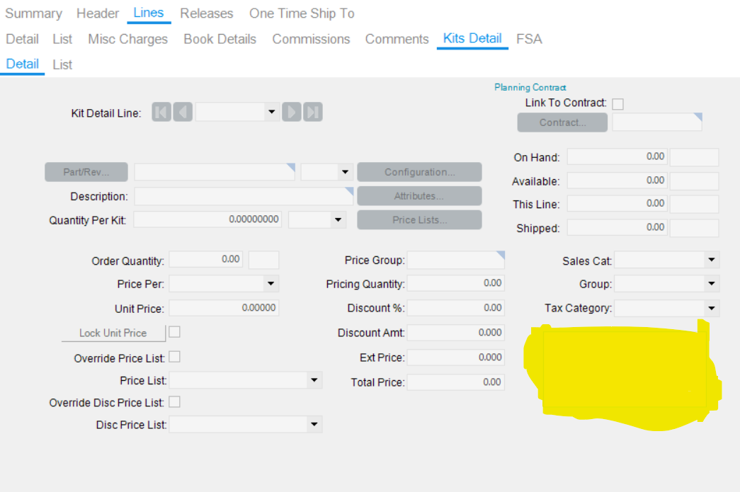

I have created a new customization, that has a text box on the Kit Detail tab of Sales order entry.
This yellow box is where our sales team wants to enter the information sales wants for the kit. I have been attempting to bind this to the orderDtl.OrderComment field, but it is linked back to the parent order line not the component line. as well as making a UD field. Both of these techniques keep tying back to the parent line (13) not the component lines.
What I need is to find a way to store this information at the component level, or even copy it down automatically from the parent, so that shipping can use it in their process.

Ideally, we would want the detail from line 14 (the component) to show up on in a text box on the kit detail tab, and have it actually update from that same textbox.

Thank you for all your input. The solution that we found for an easy solution that seems to be working for our team is to bind that custom text box to SalesKit.OrderComment and have the sales team enter the information into the new text box. I was binding OrderDtl.OrderComment previously, which was tied to the parent line and not the kit.
