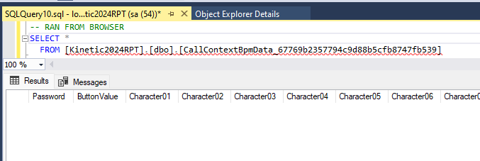

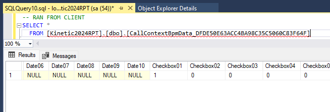

Yes, we are setting it just prior to the BO call. The thing is that when we go to create an SSRS report via Report Style - the table is created with a tableGuid in our Report Server database. And it works for us when using Kinetic, just doesn’t work with Kinetic via a browser. via the browser the table CallContextBpmdata_tableGuid is created, but with zero records.

When calling the report from the client, it works perfectly, and has for years… CallContexBpmData is an available dataset on many prepackaged reports.
However, when calling the exact same report from the browser, the CallContextBpmData table is empty.
