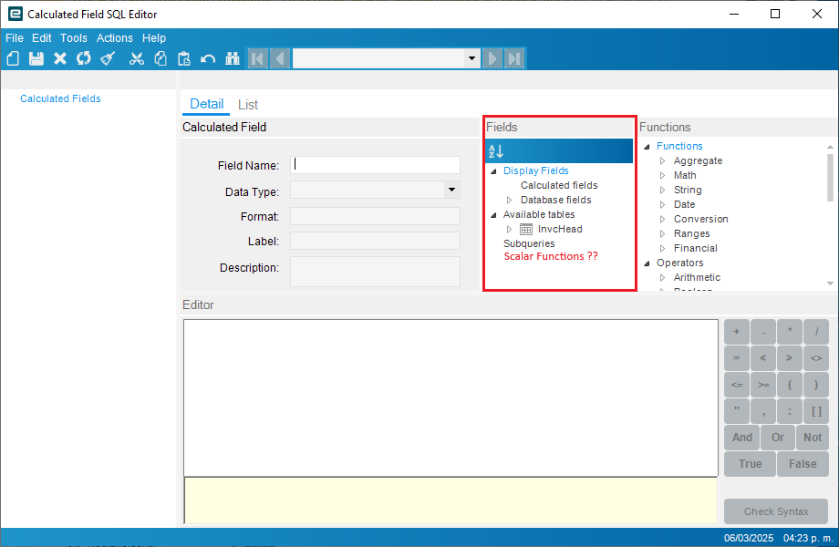

In some sections of Epcior documentation there are references to Scalar Functions in the BAQ Designer, how to enable this feature?

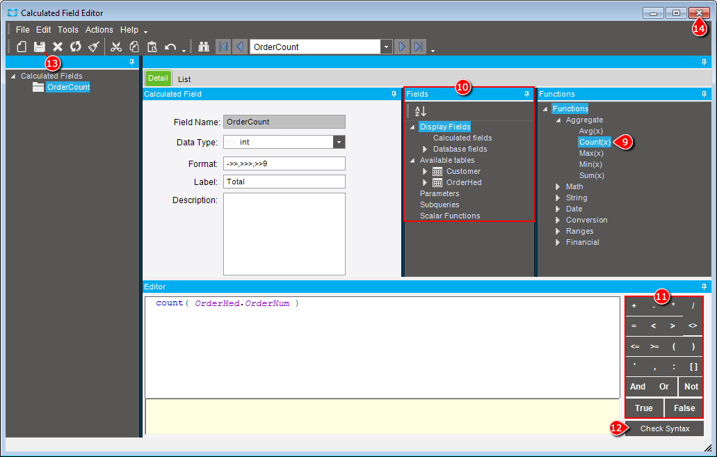

Documentation Image:
Fields (10) - In the tree view, you can select any of the current Display Fields and existing Calculated fields you want to add to the calculation. You can also pull in any fields contained within the Available tables included with the current query. If you have created Parameters and Scalar Functions to use with the BAQ, these options are available for selection as well.

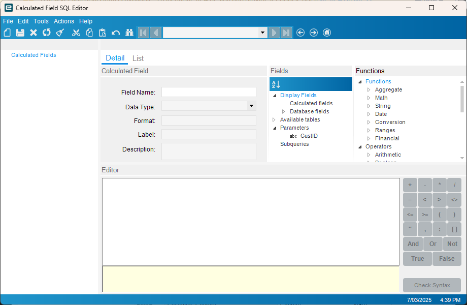

Mising Scalar Functions in Calculate Field SQL Editor in my Epcior Instance 2023.2.25
Looking in 2024.2 and in 2023.2
It does not appear to be there any more.

Unfortunately, yeah it looks like they removed that from the menu so you would have to “Just Know” that these are there. Which kinda sucks.

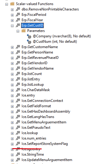

Here’s a list of the ones that show up in the database.

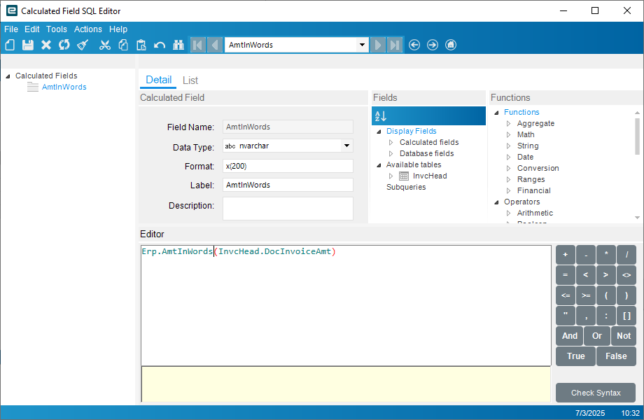

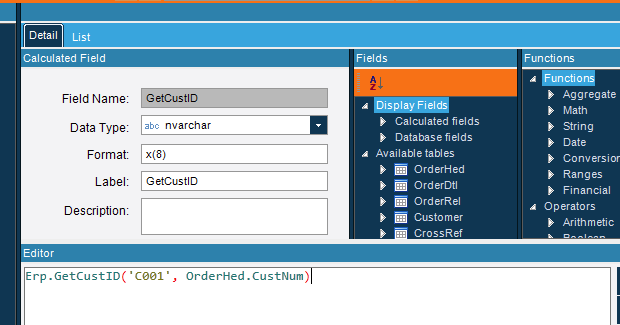

You can still type them in, it doesn’t need to show up in that menu to use them. Which is a bummer in this new land of “No Code” that they are removing easy ways to get to things that you could use. If you’re cloud, I doubt you have a way to even see what these would be. (Unless @klincecum knows of a way to get them)
Nice, it works!!
