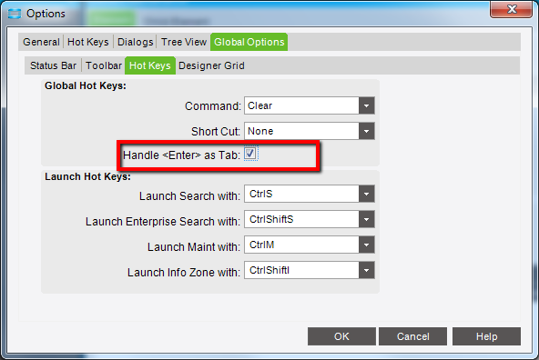

Another option is; Assumption is that they are logging into HH via a specific HandHeld UserID and in that case you could login once to the Full Client as that HH User, open up any Epicor Entry Screen and navigate to Tools -> Options on the File Menu and set the following setting:
2018-08-30_0841
Then logout and they would be all set. (If the Scanner is indeed sending a CR)

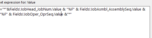

We use custom Report Styles that contain the barcodes in Code 39.
This is a sample value of the custom field:
=""&Fields!JobHead_JobNum.Value & “%F” & Fields!JobAsmbl_AssemblySeq.Value & “%F” & Fields!JobOper_OprSeq.Value &""
The barcode scanner is programmed to handle the %F separator.
Here is a screenshot as the forum is formatting the code incorrectly:
We use string designators so that it knows which barcode is being scanned to use which barcode scanner rule.
