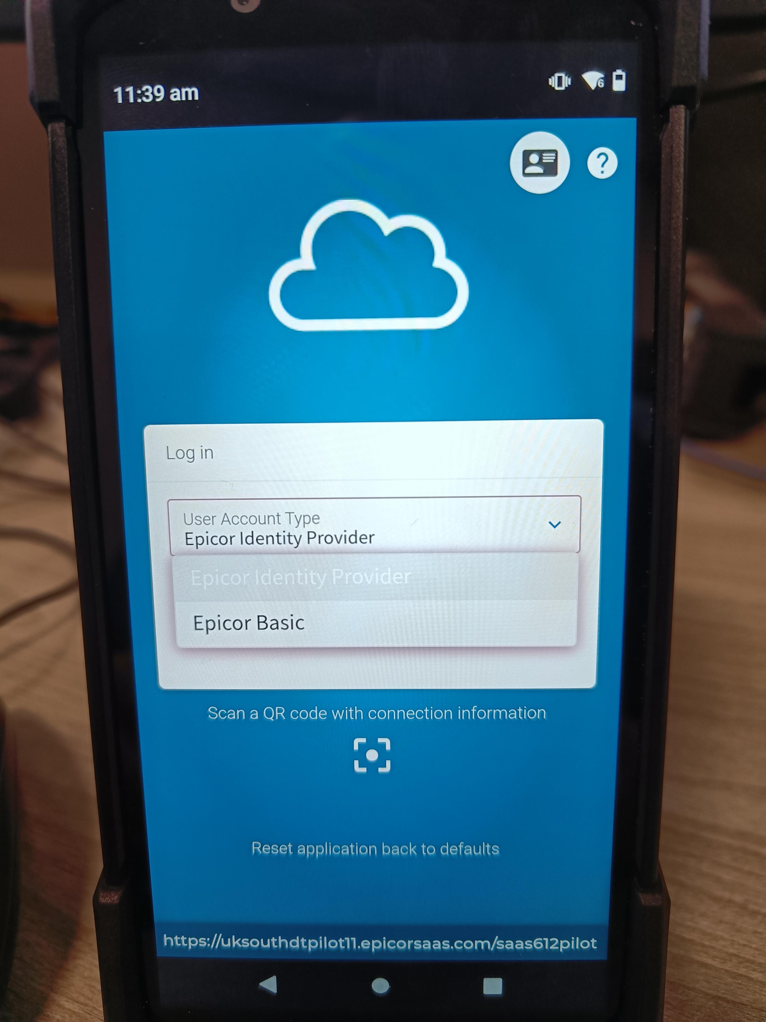

Hi Everyone,
I’m currently working on our zebra handheld scanner to try to log in using a bar code. I’ve been able to do it using this login Barcode Creator, so I will attempt to re-create in bartender.
What I am looking to find are the Values for the User Account Type so I can select “Epicor Basic” before putting in the user name and password.
I assume there is a way to find that sort of information in the browser version.
cheers

I have attempted this before. They only support username and server in the format:
{“username”:“ENTERUSERID”,“serverUrl”:“ENTERURLTOSERVER”}
If you put the password field in the string, it throws an error stating passwords are not supported.
you should see the support docs here under the “Creating a barcode” about halfway down: https://biscit.atlassian.net/wiki/spaces/BP/pages/2397044741/Login#Login-using-QR-Code
