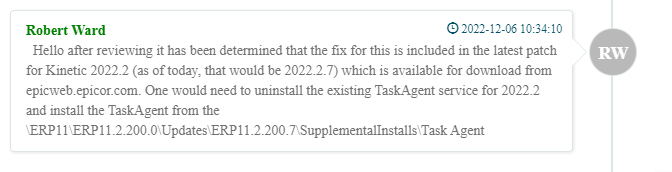

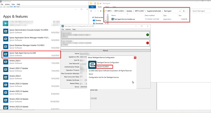

Dot releases for task agent don’t get installed automatically so if you installed task agent with an older version originally that might be what it is. It was a bug.
It did revolve around an issue with the timezone stuff they changed far as I can recall.
