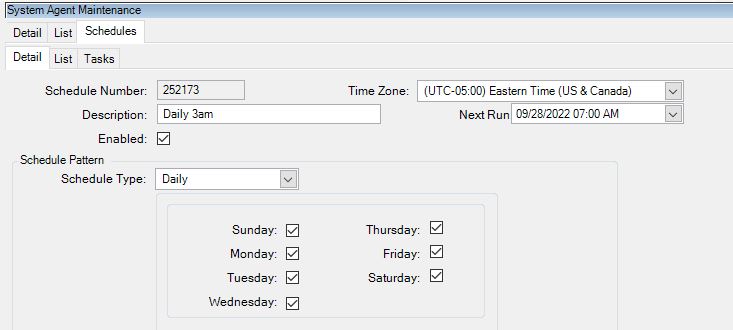

Last Friday I set up a recurring task to Generate Global Scheduling every morning at 3am. I setup the recurring task, and I also setup a new schedule (not sure on the right terminology)* that was set to run at 3am daily.
*EDIT: I used the System Agent Maintenance to create a new Schedule in the Schedules tab. The image shows the next run at 7am, but when I set this up it was set to 3am. Clearly this has been increasing itself each day.

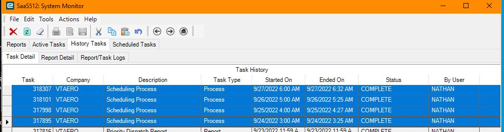

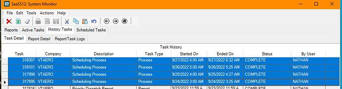

I looked at the Event Monitor this morning and the process is happening an hour later each day. The scheduled tasks shows that it will happen again tomorrow morning at 7am.
What’s going on here?

The Next Run value in System Agent->Schedules->Detail changes based on the Time Zone chosen in the same screen, when a Scheduled report runs.
Once the report runs, check the Next Run value in System Agent; it will have advanced one hour for the next day.
Possible Temp Workaround:
Schedule using Central Time (CST)

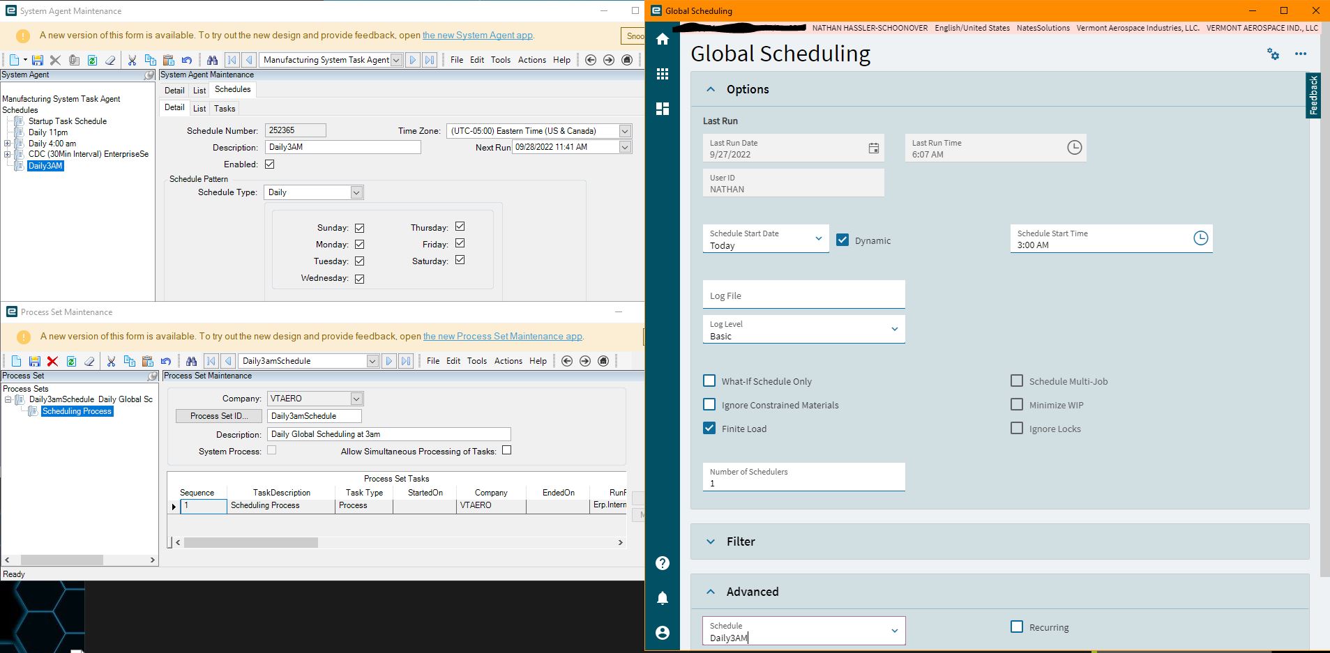

Yes, You can see in my first picture the time zone was set (-5:00). Since reading the help file on global scheduling again, I decided to delete this system agent schedule of daily 3am, and instead I added a process set. Although I don’t see a way to set the process set to recurring.
It looks like I am going to need both the process set and the system agent schedule to make it recur daily. Does anyone else schedule the global scheduling task to happen daily? How did you set that up?
So Now I have a process set saved with the Global Scheduling in it. The process set is set to daily - every day. I didn’t set the next run time, but for some reason it filled that in as tomorrow at 11:41am.
Then I went to Global Scheduling and I changed the Schedule Start Date to Dynamic = today. Schedule start time = 3am and the advanced schedule I picked the daily 3am schedule that I created in System Agent. Then I saved the Process Set. Now I can see the global scheduling in the process set, but I don’t see any scheduled task in system agent. This is so needlessly confusing!
Here is what I have setup now. Will this work?

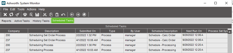

Nate - we have it on it’s own schedule and it runs just after Scheduling Set Order Process (on it’s own schedule as well so the two do not run at the same time).
Thanks Mike. Can you talk more about how you set this up? Did you use a process set? Did you setup a “schedule” in System Agent?
no process set. The Calc Order process needs to run before global scheduling, so I just submitted them to the task agent like this:
