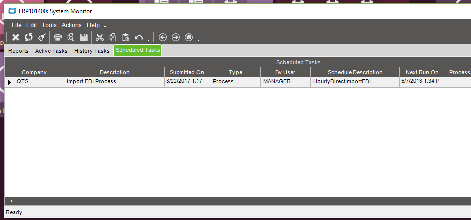

We have an “Import EDI” process that was set up by someone before me and I am trying to figure out where to specify how often the import runs. Right now it is set to run every half hour, but I can’t seem to find how and where I control this scheduled task.
Here is the next scheduled import as it appears in system monitor:

I am most likely missing something obvious, but where can I access the set-up for the run schedule?

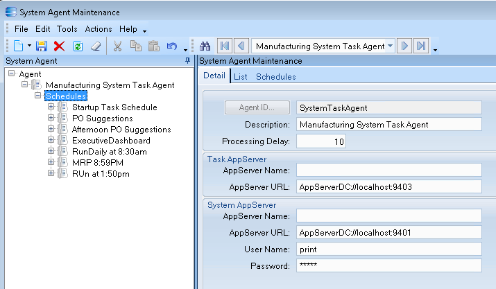

If you go into system agent maintenance you can review the schedule and task settings. This is under system management - utilities
