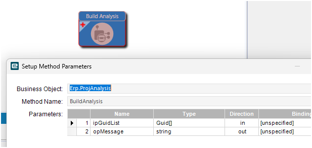

That looks like it would be an… interesting trace…
GUID list?! Not a Project list? Not a ProjectTableset like the output of the other methods in there?
That’s bizarre, on the screen, you pick a list of project ids (strings), guids don’t make a lot of sense to me.
Yeah, I would definitely do a trace. That may be some kind of helper function internal to Kinetic.

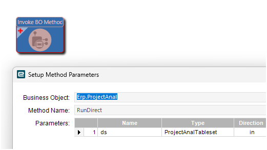

But you get the idea. Run the BAQ to get the list of projects, submit the BPA using the list as one of the parameters. If you can do directives, you can do functions!
We use the RunDirect method because we want to wait until the process is done before executing other tasks that depend on it’s completion.
We don’t have any project filters, but I assume you use the ProjectList param
This should be the same syntax as submitting the task to the task agent with SubmitToAgent

OK, glad you chimed in; like I said BPA is not my area.
I see it now - Project Analysis exists as a Process as well as the “Business Object” version that I looked at.
Yeah this looks “fun.”
I found it’s storing the list for BPA as a parameter in Ice.SysTaskParam:
Looks like a standard Epicor ~ delimited character field. If I wanted to be clever and use an SQL solution, I could just update that list. But that really doesn’t seem like a sustainable solution :slight_smile:
Edit: sorry, didn’t notice you already told me this while I was looking at it :slight_smile:
This is where the SubmitToAgent stores the parameters. You just need to do what Mr. Bayley is doing and provide the ProjectList as a “~” delimited string of project IDs and you’re all set. He’s running it directly, so it waits, but you can use the SubmitToAgent to have it run as a Task.
