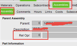

We are back to business and trying to optimize our job scheduling. We would like to consolidate our jobs into subassemblies to ensure they stay aligned and connected when changes are made. We’ve therefore moved a child component (previously on its own job as make to stock) to Subassembly 1 of the finished good. The problem is that the Parent Subassembly is happening as we manufacture the child component (so more or less concurrently), but the system is scheduling the subassemblies sequentially. I have tried to use start-to-start, with a send ahead, however it seems that this would only apply to two ops with in the same Subassembly. Any suggestions on how to configure this? Ideally, we would have both subassemblies begin at the same time, however, I am ok if I needed to build in a slight offset.
