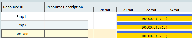

Pretty sure I got it! I’ll have to do some more testing and will post it later. In the image below, WC200 was always going past the 2 employees until this try.
Did you have to halve the standard hours to achieve this? Or were you able to dynamically let the system calculate available resources using scheduling blocks?

Just wait, I’m still testing different scenarios. But I used scheduling blocks in my example. I did not halve the standard.
