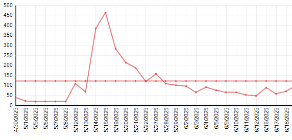

One other question I have is what causes the load graph to look like this? This happened after running global scheduling in test. It looks like this for all resource groups, huge spike on the day I ran global that goes way above capacity. In the resource scheduling board’s list view, I can’t find anything that would indicate this large of a number (462 actual hours with only 120 hrs of capacity)
