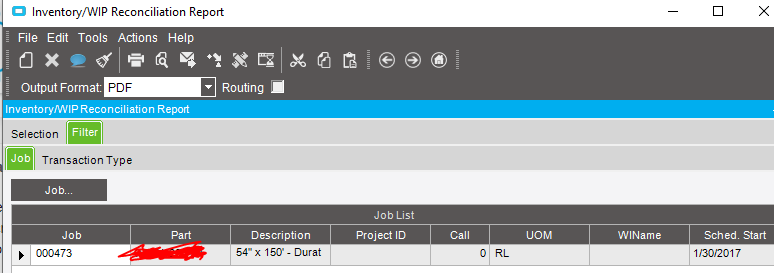

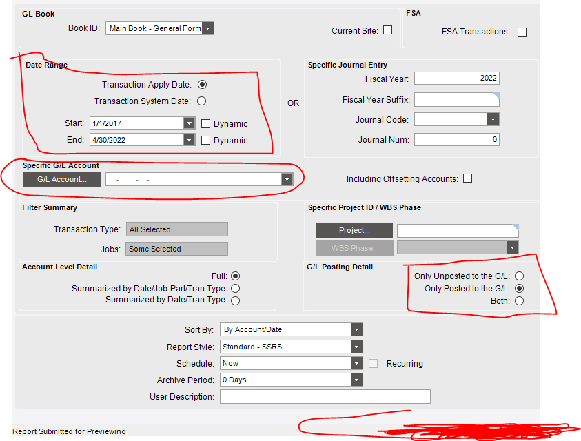

Here are some screenshots of the IWR report.
You can run this for a specific GL account with specific transaction types for a specific job if required.
In your case I would put in the job in the filter tab and then adjust the transaction date filters to include the dates that match the life of the job.
Choose also whether you would like to see posted transactions or unposted or both- this all depends on whether you have posted capture cos wip or not.
Now when you print preview it, all GL transactions will show, including the scrap costs.
At the end of the financial period, these entries are what get posted to the related accounts. These are a portion of the transactions that your financial statements are based off of.
