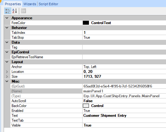

I can’t find scrollbar properties on the Form.
On the Panel, the only option is “Auto scroll” which I have tries both True and False (but neither worked)
From Panel:

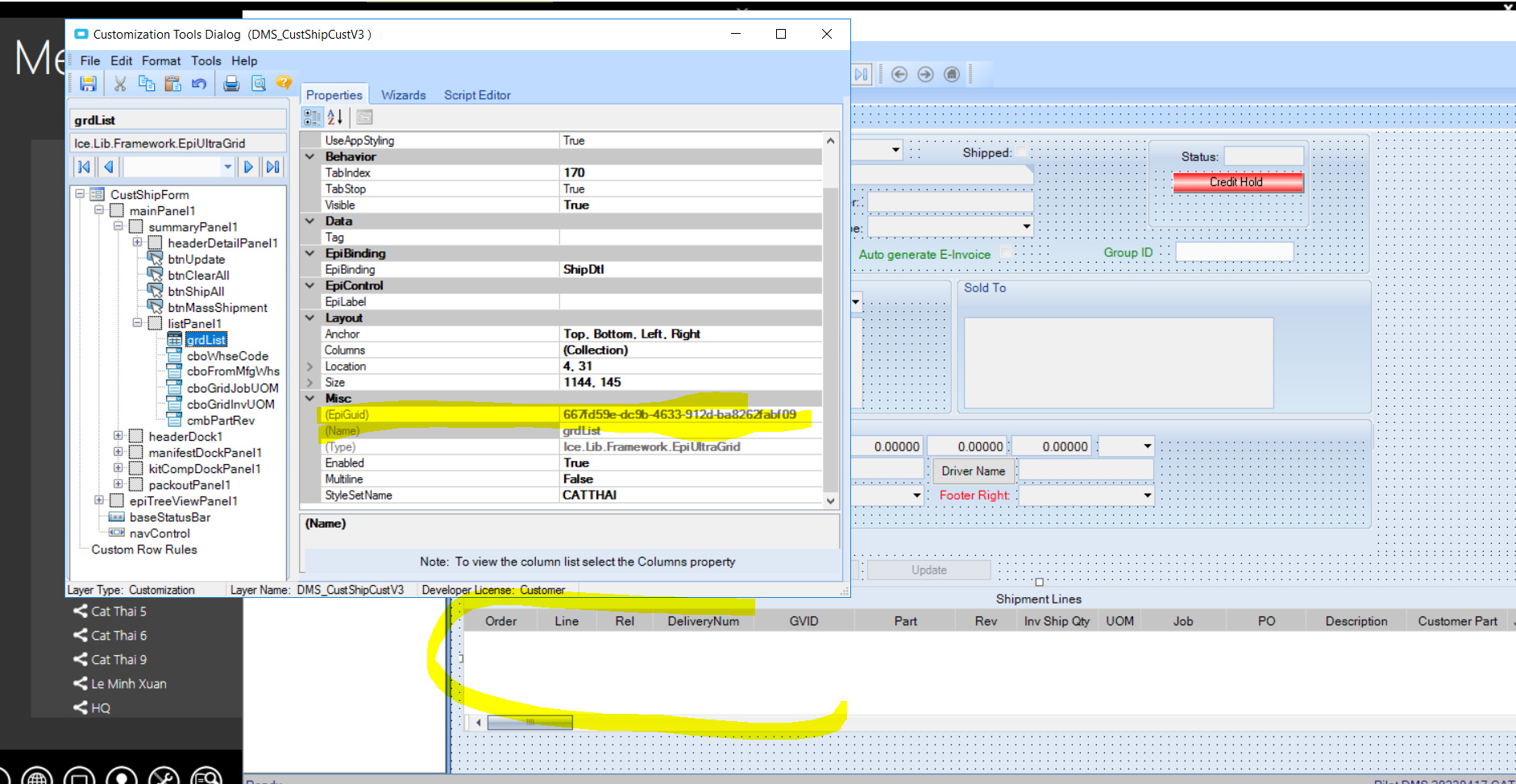

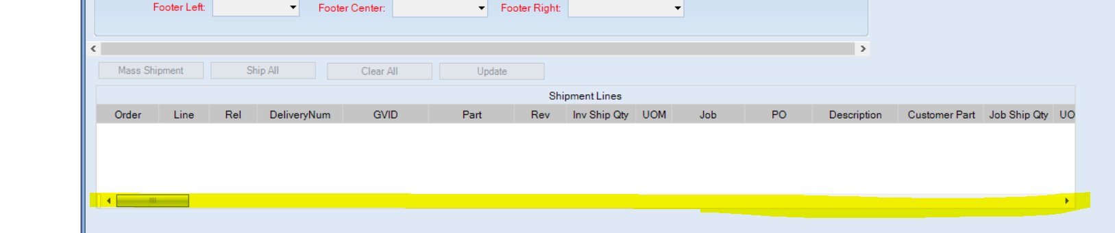

You can customize using the Dock control property to show the Scroll bar again or you can use the Copy To Excel feature to excel to check for hidden columns.

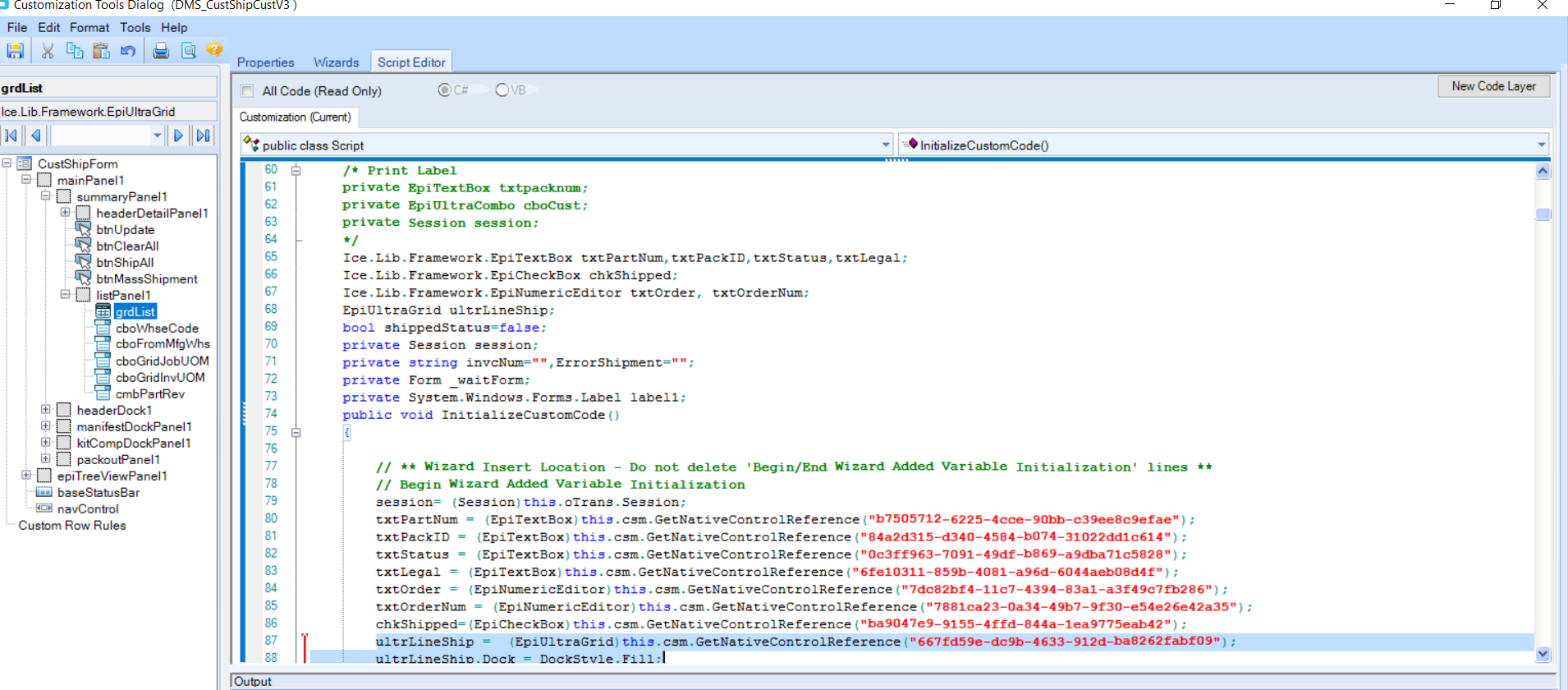

using System.Windows.Forms;
EpiUltraGrid ultrLineShip;
ultrLineShip =  (EpiUltraGrid)this.csm.GetNativeControlReference("667fd59e-dc9b-4633-912d-ba8262fabf09");
		ultrLineShip.Dock = DockStyle.Fill;

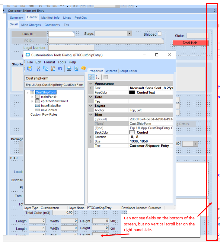

The scroll bar is missing not on a grid, but on the main screen - the Customer shipment entry screen itself.
I have added some fields onto the bottom of the Header tab, but can not scroll down to see them.
Please see below a screen print of the screen and also the From properties available.

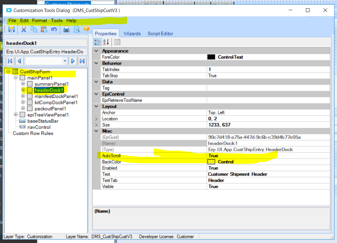

If so, check the headerDock1 property again.
after editing you have to turn off the screen and reopen customization
Have a good day! :smiling_face_with_three_hearts: :smiling_face_with_three_hearts:
Thanks for your detailed response.
I had already changed the headerDock1 “auto scroll” properties to true and to false and it hadn’t worked before, but I tried once again, flipping to false and then back to True and it seems to have worked! I wonder if it is to so with a certain order of events.
