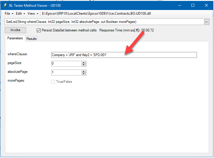

I think it returns a getlist on the BO when the search is called. The WhereClause described in the link is the same as what the GetList method accepts. I like to visualize this with the BL Tester utility.
Ultimately, I believe that the SearchOptions object is really a wrapper over GetList/GetRows in an attempt to make it easier to use.
Understanding your requirement will help steer you in the right direction though. It sounds like you want a custom view of the data returned to the user rather than a behind the scenes lookup/return, so I’d still opt for either a dynamic query or invoking a quick search with custom BAQ behind.
