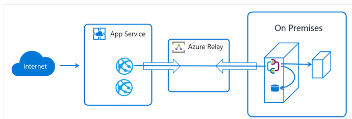

We use Azure Hybrid Connection
Thanks Haso.
@tkueppers and Haso, would something like a hybrid connection app service work natively with the apps epicor makes such as mobile warehouse and mobile crm and the epicor environment itself? Or is this something that would have to be programmed for within the source and target applications in order for this handoff to work?
In other words, what, if anything, in this diagram is epicor? I assume that nothing is handling the authentication from the relay in Epicor, rather something on the network outside of epicor receives the request from the relay and then posts the rest call, right?
An Azure relay won’t help us if we’re on prem … or am I missing something?
You are missing something. That box on the right is the on premises as I understand it. It looks like something that gets the request from the relay and then I don’t know what you do after that. I think you use it in an application to do something?
That was my question to Haso, what do you do with that now, do you have to build something custom to consume that handoff and make a request or can I natively use Epicor and Epicor apps with this relay technology? Additionally, where does epicor sit in this diagram? Is it in the on premises box if we are on prem?
