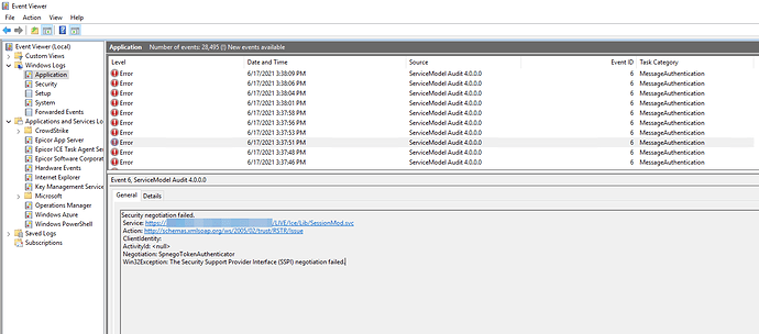

On our app server, in the Event Viewer, we’re getting several errors. While they don’t seem to be hampering the use of Epicor, it makes it very difficult to weed out things I need to see when something does go wrong since this error is flooding the log.
Anyone have an idea of what’s causing it and how to fix it?
Epicor Support immediately blew me off and referred me to CSG.
Fixed it!
Windows Auth was disabled in IIS.
