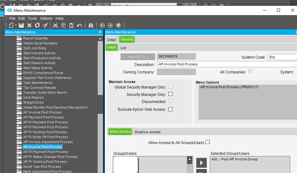

I want to restrict users who have access to AR Invoice entry to only allow a person or security group the ability to Post the group but are having issues with the security I setup on the process is not followed. Figure it should be straight forward to do.
In Menu Maintenance under Processes node is the AR Invoice Post Process - Menu ID PR000117. After added the new Security Group which myself and my test user is NOT a part off, we can still post invoices. Version 10.2.400.5.
I feel I shouldn’t have to add anything to Process Calling Maintenance for this one as the process is already called in from Action -> Group -> Post in AR Invoice Entry.
This setup works on Processes we have created, however this is the first one I am doing on a system menu. Am I missing a step or running into a bug?
Use Process Security.
Note that Sec Managers automatically override these settings
Chose the BO (ARInvoice), then add a Method (PrePostBOEInvoice in bo.ARInvoice I beleive), and setup security like it was a menu
CORRECTION
Choose process Proc.ARInvoicePost Then add a method. Not sure which one. But SubmitToAgent in Proc.ARInvoicePost might work Then set the security. No need to choose a specific method
The menu item will still be enabled, but users that don’t have the security will see,
Note: After clicking OK on that pop-up, the Invoice Entry screen will be cleared, appearing like the posting was successful. Searching, shows that it still exists and is unposted.

In version 10.2.300 the program is called Service Security Maintenance (not sure why the name change)
It’s exactly what I was looking for. Interesting that we have to use Service Sec Maint instead of controlling it from the Process in Menu Maintenance. Oh well, at least it works as I want it to.
