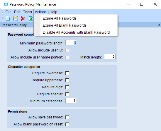

I need a help on how I can archive the below;
  1. Disable Epicor user accounts that have been dormant for 90 days.
  2. Disable epicor user accounts whose blank password is not updated after 5 days of account creation or reset to blank password.
What version are you on @rosesway?
In 10.2, use Password Policy Maintenance to take care of those pesky blank passwords since they are a security risk.
If you set you password expiration to 90 days, it will disable accounts that haven’t updated their passwords. Sometimes that’s less than the dormant time but safer. The other option is to write a BAQ that shows date last used > 90 days and then run a DMT to disable the users. This could be done from a PowerShell script. (You’ll trap a lot of high-level managers with this rule…) :wink:

10.2
Thank you Mark! this will help me for those with blank password… I hope this will apply to all companies because I do have around 185 companies in one database.
