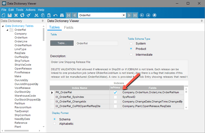

You can go to the Data Dictionary Viewer. Create a personalization and in the Indexes grid unhide the IsPrimary field. Then when you bring up a table the IsPrimary will be checked with the fields.
Hello @afabian,
thank you for your answer. It is useful. Regards.
