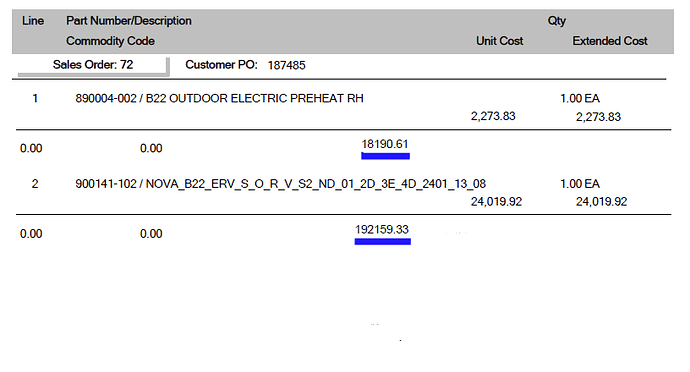

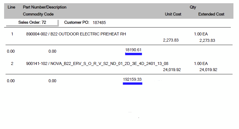

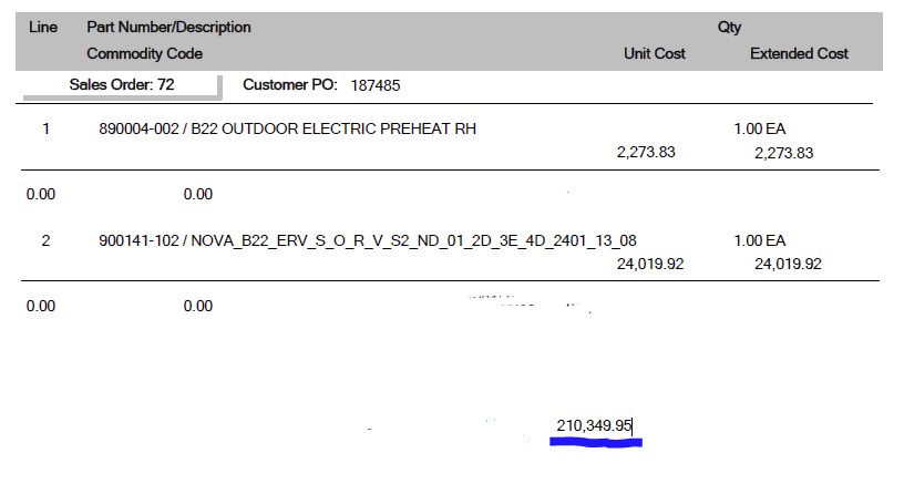

For an unknown reason, my SSRS sum expression is returning the incorrect value. In fact, the value is always 8 or 12 times (on the dot and seemingly random) of what it should be. I’m using the below formula to sum up the total value of my PackSlip report.
=Sum(Fields!OrderLinePrice.Value * Fields!Calc_DspPlannedQty.Value)
If I try it on each line, I get the same issue.
=Sum(Fields!OrderLinePrice.Value)

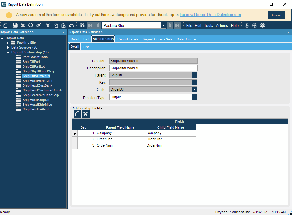

This is the table relationship in the Data Definition.
And this is the JOIN statement
LEFT OUTER JOIN OrderDtl_" + Parameters!TableGuid.Value + " T10 ON T2.Company = T10.Company AND T2.OrderNum = T10.OrderNum AND T2.OrderLine = T10.OrderLine
