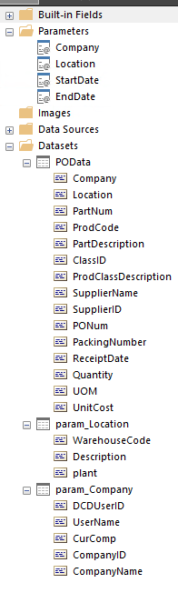

I am creating a report aht the end user will direct from SSRS. We ahve it set with three Data sets (POData, param_Location,param_Company) and four parameters (company,location, start, end).

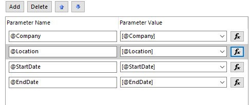

Within POData we have the parameters as shown:
When using this report it gives a dropdown to select the Location. However, there isn’t an option to Select All. Which, we need. What is the best way to do this?
Note: The company parameter feeds the Location, the Location and company feeds the POData.
