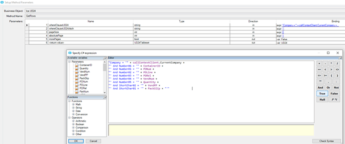

We are using Landed Costs and Container Receipts. When a landed costs container is created and “Shipped” it basically stages the receipt with everything it needs other than Serial Numbers. I was planning on having the Buyers who created the landed costs container upload the Serial Number along with PackSlip, PONum,POLine, PORel, VendorNum, PurPoint.
When the Receiver goes into Container Receipt and “saves” a RcvDtl Line, I want to trigger a Data Directive to query UD24 to get the SerialNumbers associated with that container line and populate them for the user.

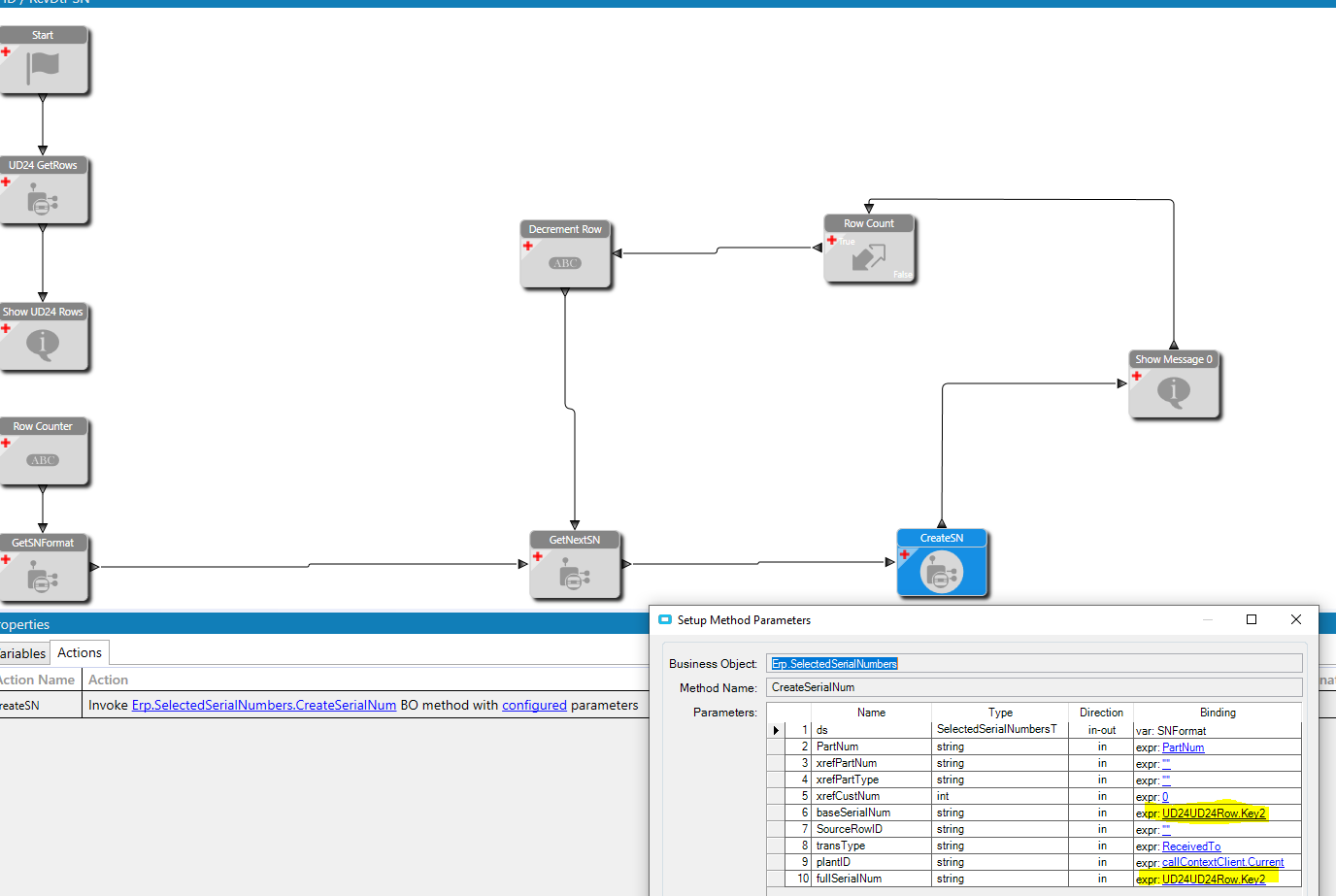

I did some traces and found a number of the BO I need to call to replicate what Epicor is doing when the receiver creates the Serial Numbers manually.
ERP.Proxy.BO.ReceiptImpl GetSelectSerailNumberParams
ERP.Proxy.BO.SelectSerialNumbersImpl GetSerialNumFormat
ERP.Proxy.BO.SelectedSerialNumbersImpl GetNextSN
ERP.Proxy.BO.SelectedSerialNumbersImpl CreateSerailNum
Repeat for total number of Serial Numbers = ContainerShipQTY
x) ERP.Proxy.BO.SelectedSerialNumbersImpl GetNextSN
xi) ERP.Proxy.BO.SelectedSerialNumbersImpl CreateSerailNum
ERP.Proxy.BO.ReceiptImpl ReceiveContainerUpdateUsingArriveDate
I basically tried to create a Standard Data Directive on RcvDtl looking for an added line to RcvDtl that has a container ID populated.
Then I began to Invoke BO Methods and define associated TableSets for

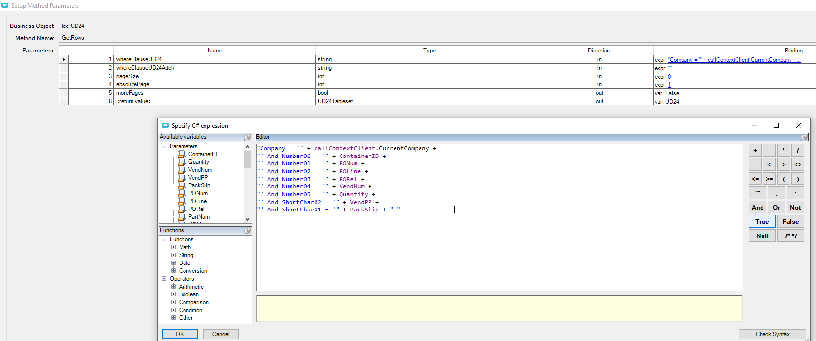

Ice.UD24.GetRows Filling a UD24TableSet Variable
EPR.Receipt.GetSelectedSerialNumberParams Filling SelectedSerialNumbersParamsTableSet variable
Erp.SelectedSerailNaumbers.GetSerialNumFormat Filling a SelectedSerailNumbersTableSet variable
Erp.SelectedSerailNaumbers.GetNextSN Filling a SelectedSerailNumbersTableSet variable
Erp.SelectedSerailNaumbers.CreateSerialNum Filling a SelectedSerailNumbersTableSet variable
I didn’t get much passed that as none of it seemed to work
Initially I got the Error that ‘SelectSerialNumbersParamsTableset’ exists in both 'Erp.Contracts.BO.Receipt and 'Erp.Contracts.BO.SelectedSerialNumbers
I removed the connections from all the BO I invoked other than the UD24 and added an Email notification to see what id the UD24 variable I created and attempted to populate. This the Error I got when I saved the Container Receipt
