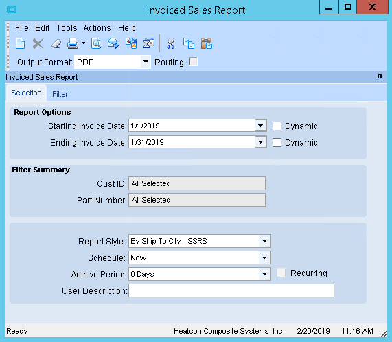

I am attempting to create an SSRS BAQ report where the end user selects a specific date range to pull in sales orders that have been invoiced. Out of all the records returned in that date range, each record has a field entitled ShipTo_City. We would then like the end user to be able to select ShipTo Cities based on a DISTINCT list of Ship To Cities within that date range. I have achieved this in the SSRS Report Developer in Microsoft Visual Studio and works perfectly, but when I try to implement it within Epicor, I get the following error message. Obviously, I have missed a step, or what I am attempting to do is not possible with SSRS.
“Program Ice.Services.Lib.RunTask raised an unexpected exception with the following message: RunTask: This report requires a default or user-defined value for the report parameter ‘ShipToCity’. To run or subscribe to this report, you must provide a parameter value. —> Microsoft.ReportingServices.Diagnostics.Utilities.ReportParameterValueNotSetException: This report requires a default or user-defined value for the report parameter ‘ShipToCity’. To run or subscribe to this report, you must provide a parameter value.”
Following are screenshots illustrating the way I have the parameter and dataset configured:

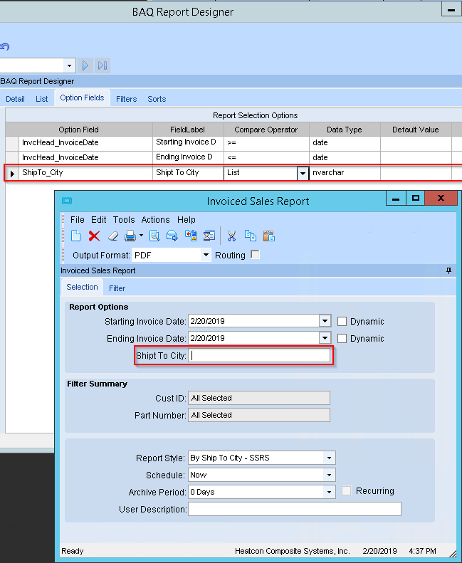

Yes Calvin, that is correct. However, the ShipTo_City field is not available under the Filters tab but under the options tab ShipTo_City is available. That being said, the end user has no way of knowing what cities are going to appear on the report based on their date range. On the options tab they would need to know what cities to populate in to the field as a list. It would be a shot in the dark to guess which ones unless they ran the report for a date range in its entirety, looked at all of the cities that appear on the report and then run it again populating the option field ‘ShipTo_City’ on the ROI with the list of cities they want. There is also the element of them mistyping the name of the city…

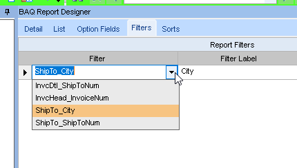

It takes a little bit of extra work, but you can add the ShipTo_City to the filter. It requires adding the field in your BAQ as a Like column, and creating a Context Menu entry.
Running the report shows:
With the filter showing:
This isn’t super elegnat, as searching for the city by clicking the City button basically just shows all the possible ShipTo’s. It doesn’t limit the search results to ShipTo’s with Invoices that fall in the range on the first sheet. But if you can filter the search window by city, and then select any shipto with the matching cities.
