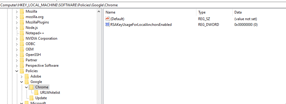

This happened to us about a week ago. Here is the fix that I used both chrome and edge. I would call it a temporary for now until we get the cert corrected or an actual cert. Been pushing it off.

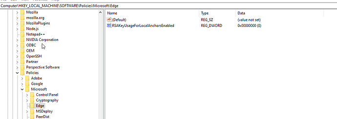

Adding the Registry key for Edge as @mmcwilliams mentioned worked for me to be able to access EDD on our Productions server with Edge.
