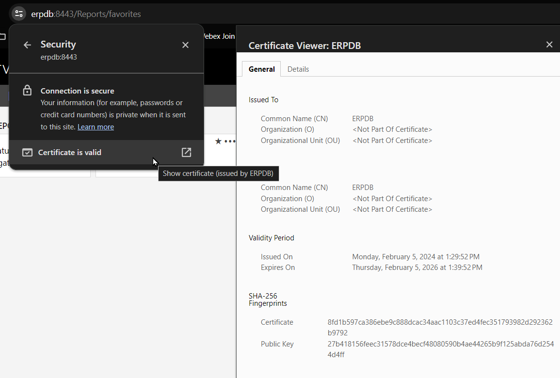

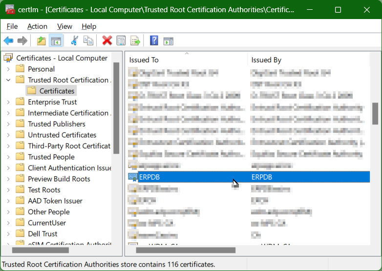

Chrome will accept once you install your generated self-signed cert into trusted root authorities on the local machine.
Probably you are not in those Chrome users that started getting this error.
Google updates small percentage of people, which is understandable, but make it hard to troubleshoot
I believe they are just not adding it to Trusted Root on the Local Machine they are using to access via Chrome browser.
Also, may need to restart the browser completely sometimes.
Nope fully up to date:
Still working :slight_smile:

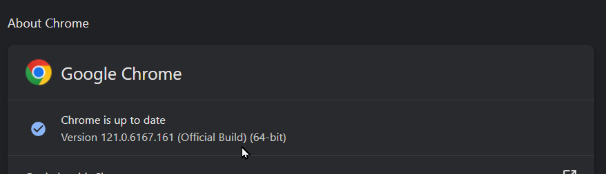

I can’t explain this. For some people it works, for others - does not. Yet it depends on Chrome you have. Maybe we need to google the answer :slight_smile:
Many large web-based companies do a roll-out based on groups (A/B, rings, etc.). If one is not in a leading group or ring, the update will not appear even if we check for updates.
Mine is the same and I saw this error with certs created in IIS.
Version 121.0.6167.161 (Official Build) (64-bit)
Maybe it is not a version per se but some flag switched on/off
