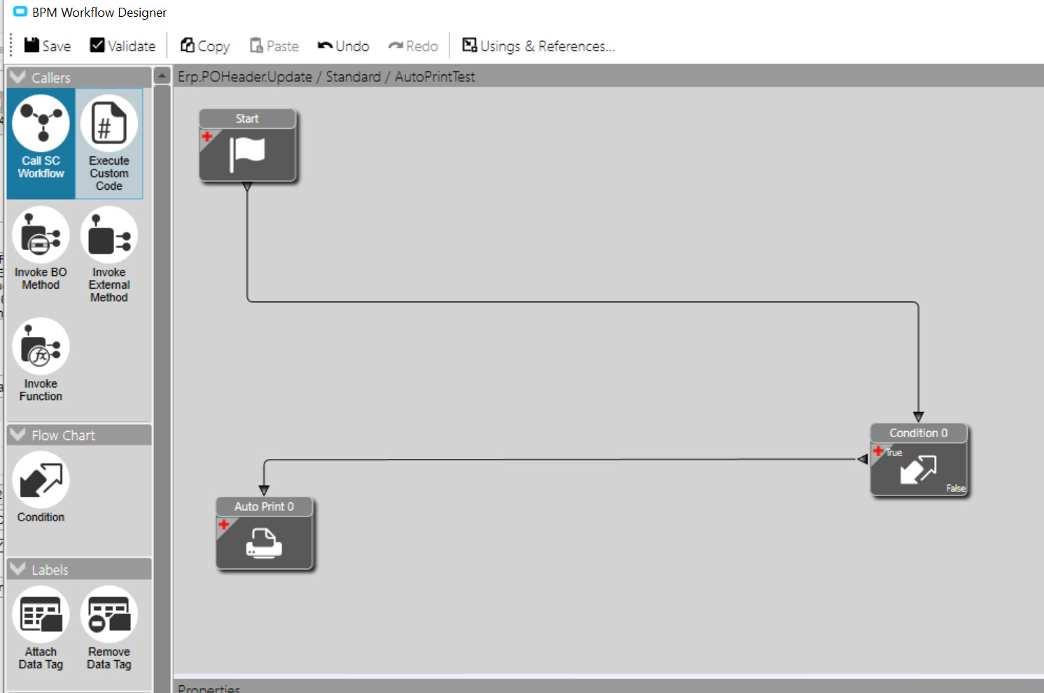

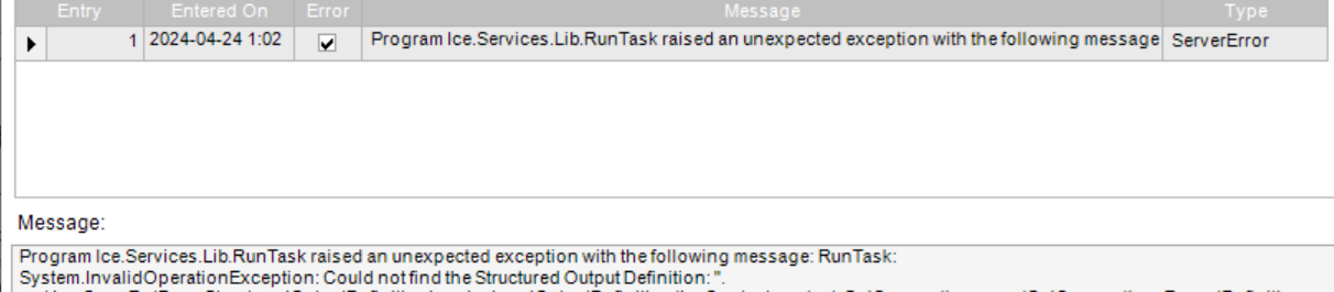

I have tried AutoPrint however it only contains POHeader data definition and does not contain the rest of the required datasets. BAQ reports are sent flawlessly this way however SSRS reports all face this issue:
I get this error using AutoPrint:

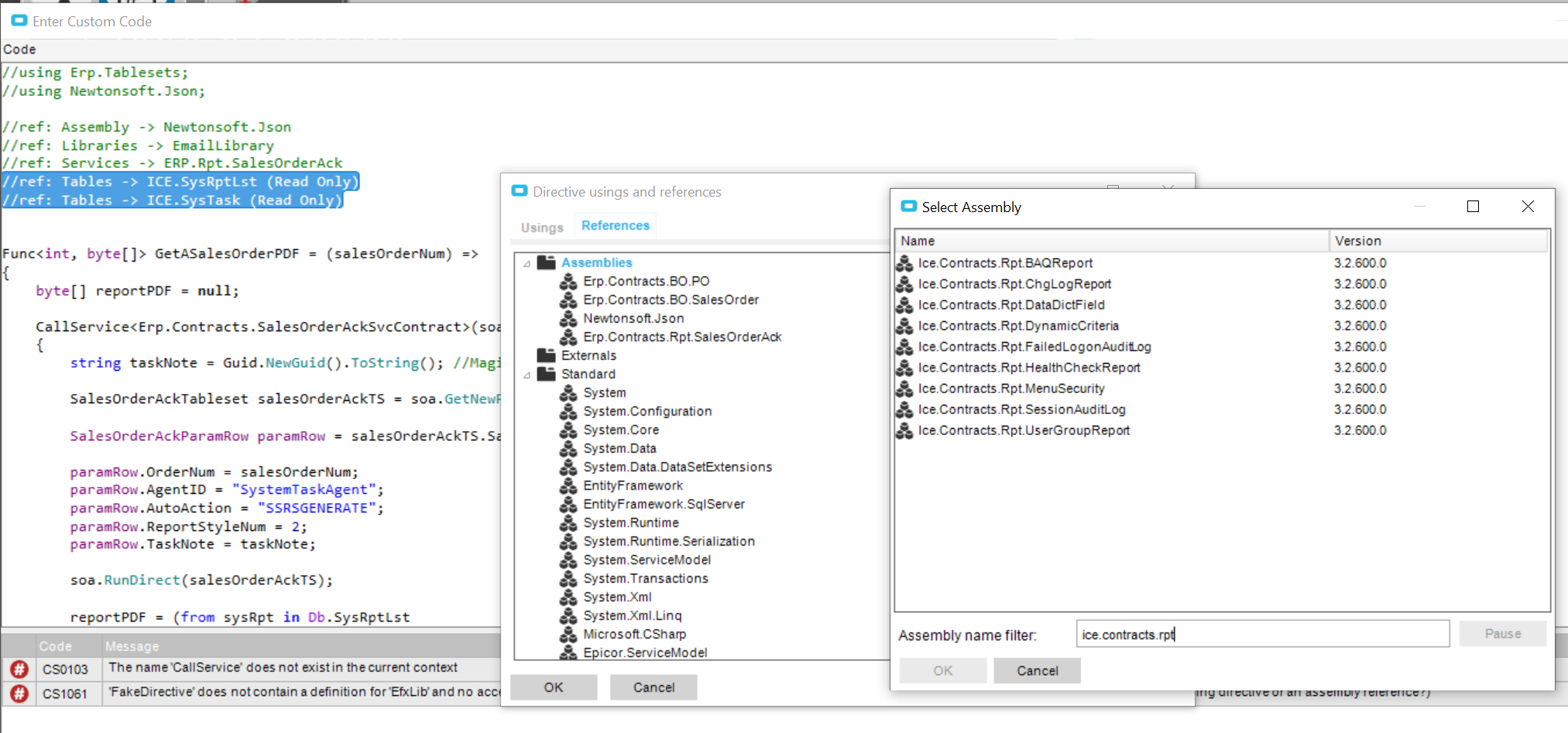

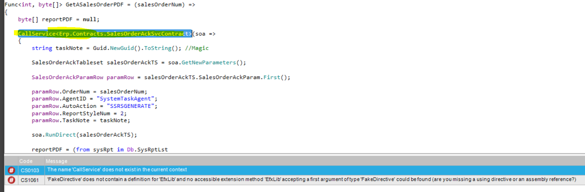

I am having difficulty finding the last two tables, am I doing it wrong?
I cannot see them in the list, many thanks in advance :slight_smile: :
I am also getting two errors:
Yes, I just mentioned “ref” as in literally referring to the tables used.
Db.SysRptLst etc
Yes, the example was not specific to POForm, you will have to trace and interpret how to do it from there. I would assist, but I do not have the time.

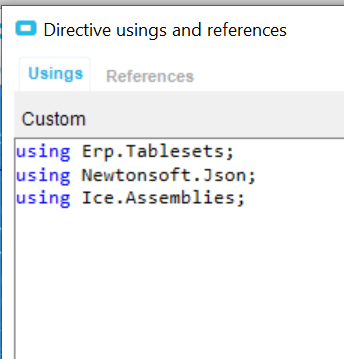

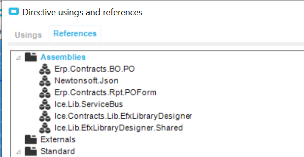

First I added these references:
Then I added these Assemblies:
The last 2 are not required, I forgot to remove them since I used a different method to send the email.
And this is the code:

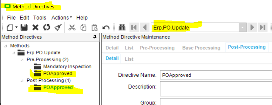

I also caught the trigger on Pre and transferred it to Post (should be Method Directive, Update) and this code is in Post.
