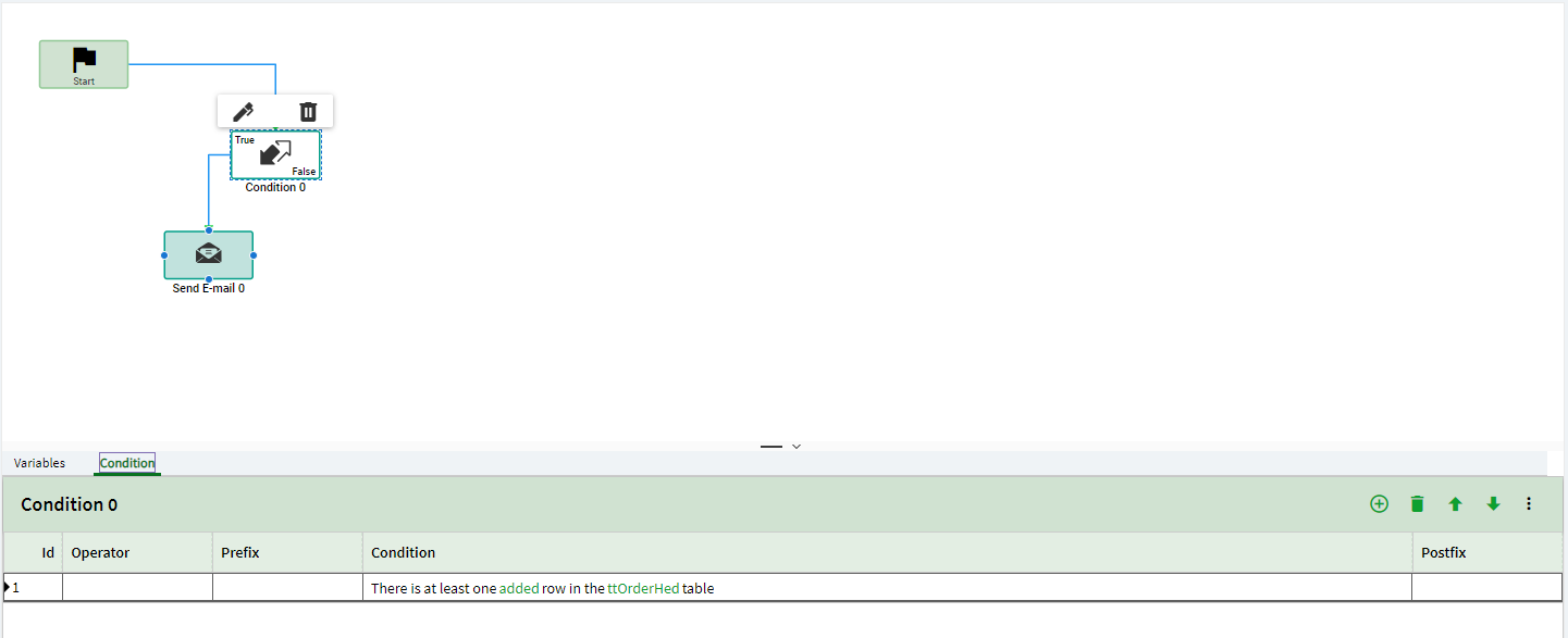

Hello Experts, I am in need and again seeking your wisdom on Method Directives
I am trying to auto send an email when a Sales Order has been created Either Manually (direct order entry) or converted from a quote.
I made it upto the Manual entry, But not sure how to also include the other condition which is from From Quote to order.
Hoping to get some guidance into solving this. Thanks in advance. Cheers!
@PaulC You could write a data directive on the OrderHed table and add a condition where there is a row added to the table. I just tested this for a quote and it sent an email.
The crux of this request is, what information do you want to include in the email?
If it is just an alert that a SO is created… then it should be easy. Like @tsimon shows, a DD on OrderHed looking for added rows should get you an email “alert”.
But if you want the email to include information on what is IN the sales order… its a lot tougher. You only have to enter the customer in order to save a new Sales Order, but that’s about it.
If you want line item details, SO total value, etc… it becomes muddy. There’s no out-of-the-box trigger for the system to know the user is done working on the sales order… time to send out the email alert. This is very dependent on how your company operates.
I’ve gone a slightly different route here and use a function to send out a sales order alert every day at 7AM. This is populated by a BAQ that specifically looks at orders entered (or changed) the previous day. My company president wanted to see values… so, the “super good enough” solution for me was to get him a summary of what happened yesterday.
@tsimon - Thank you, I think I overthink this one resorting to Method directives. I would start with this and probably polish along the way. Thank you and much appreciated
