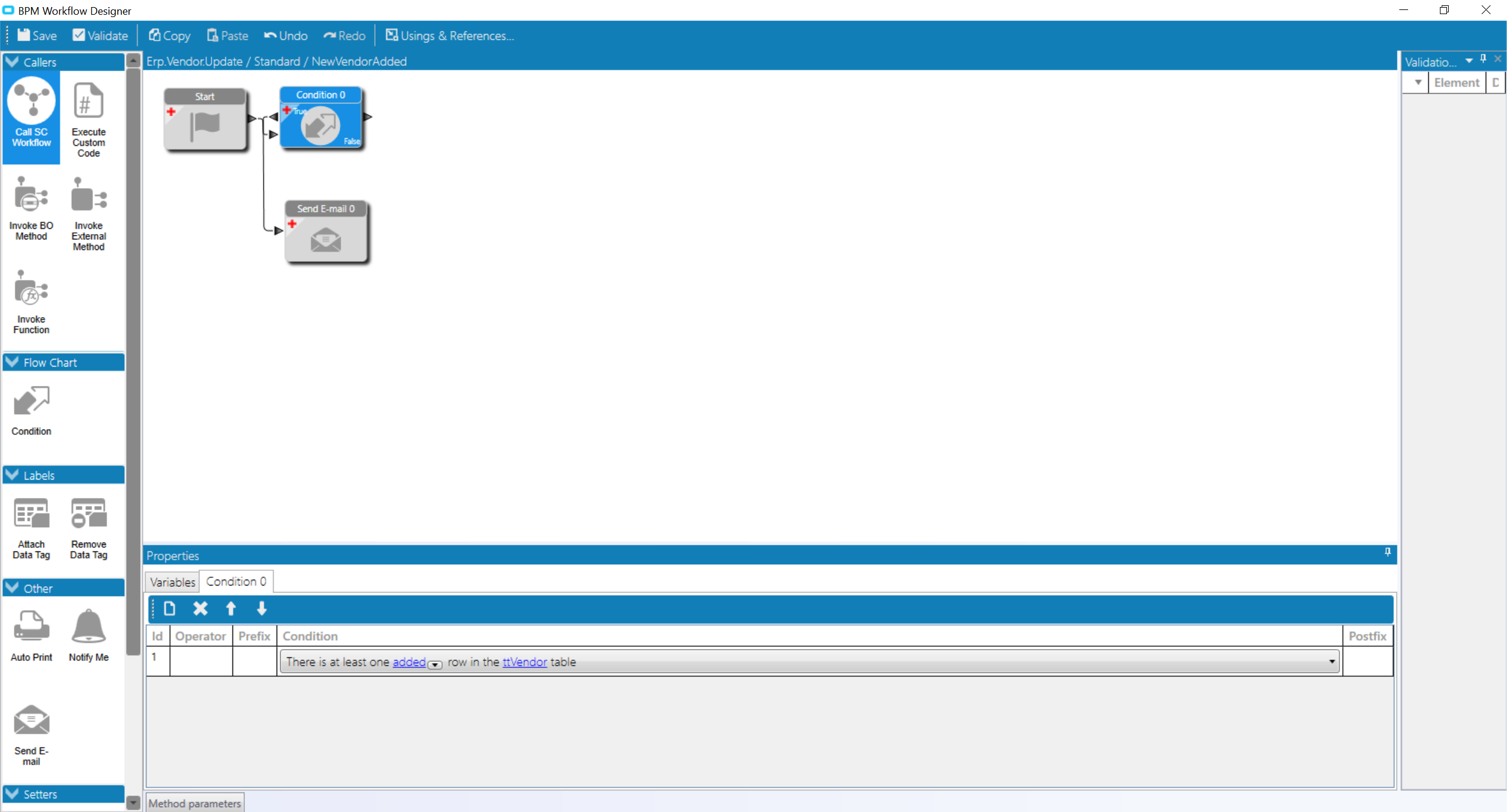

New BPM user here. I created a simple standard BPM to notify via email when a vendor is added. I thought I had it working in Pilot, but is not working now.

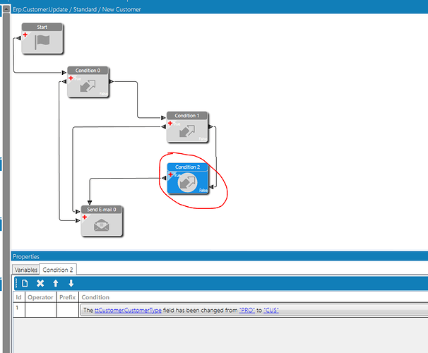

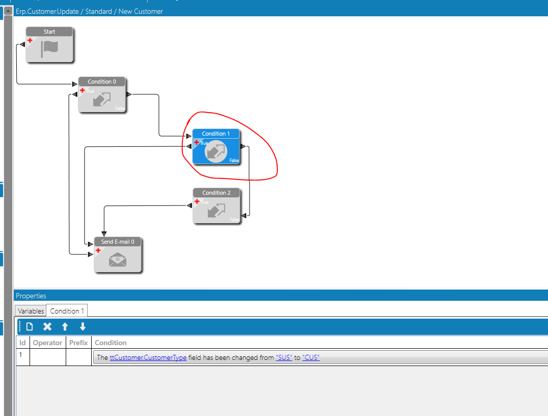

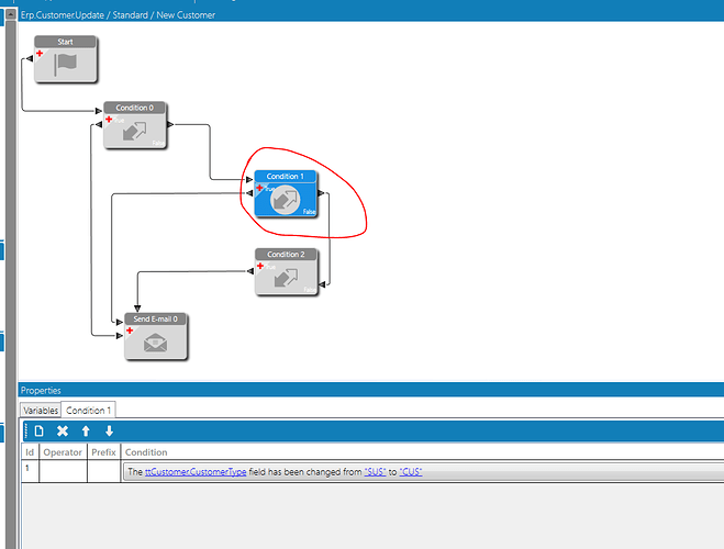

@dllambros You might need to add a few more conditions in the BPM. Here’s one we have set up to fire off an email when a new customer is added - a new vendor is likely similar in set-up.
First condition:
Second:
Third:
Hope this helps.

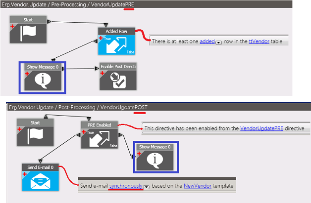

In addition to what others have already mentioned…
I sometimes will use a PRE process BPM to enable POST process to do the sending of the email.
And when I’m not sure what is/isn’t firing, I’ll temporarily add messagebox(es) to get some immediate feedback.
e,g

P.S. one note about adding test messageboxes - location can matter, prevent subsequent processing. e.g. in my example screenshot, the pre-preccess after the 1st condition
- that temp messagebox would give some feedback on true BUT… can also prevent the enabling of the post process.
