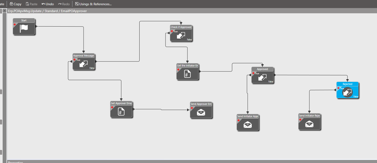

I created a standard data directive on the POApvMsg table
It emails the approver when an PO needs approving and emails the buyer when a PO has either been approved or rejected.

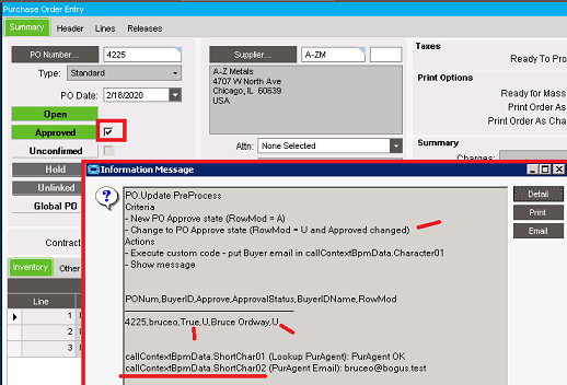

If you have a test system & want to play around, here is a REALLY simple method directive.
When Approved is toggled on a PO, it pulls email via custom code and displays some details.
POApprove_GetBuyerEmail.bpm (30.2 KB)
Ref screen shot

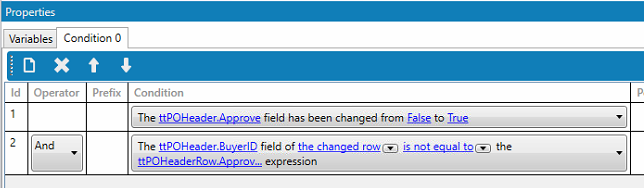

I agree with @bordway once you get a few down you will like it. I had a bunch of BAMs in E9 and this is how I converted them. You can reuse the code for most alerts.
This is on a standard data directive.
I set a condition:
Then called an E10 version of a BAM .p program in the custom code.Alert PO Approved.bpm (17.9 KB)
