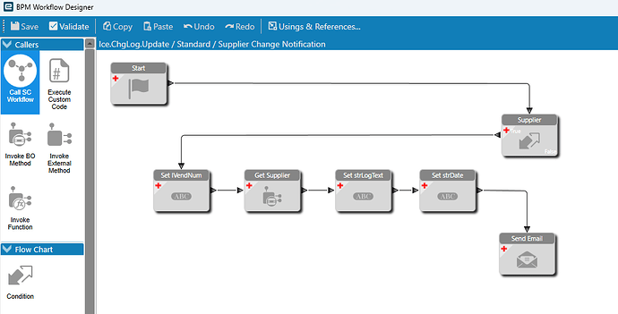

So, this is my Data Directive:

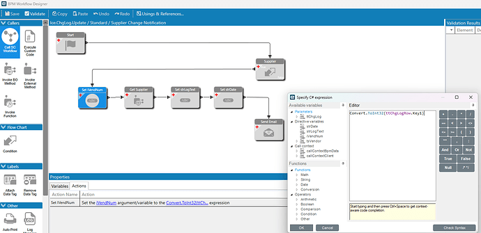

You can see I’m grabbing the VendNum from the table:

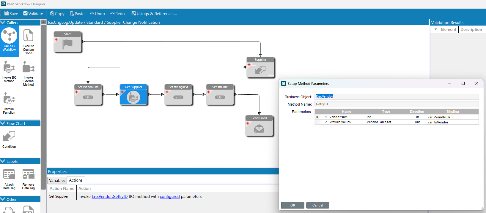

then use that to get the Supplier Information

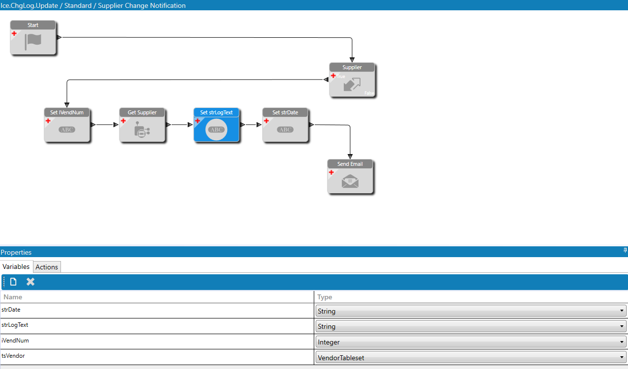

Set the remaining variables

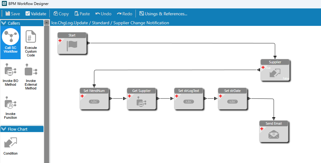

Finally, use those for formatting the email.
That makes sense, I was trying something similar, but forgot to change Key1 to integer.
