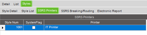

Then I noticed that in Report Style Maintenance there is a “SSRS Printers” section. So, I went ahead and threw in the IT Printer (which is set up as a printer in Epicor).
Either that does nothing unless the AdvancePrinting module is available, or it is broke…because it does not seem to do anything at all. Or, am I completely missing something with that?
