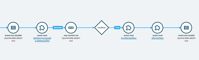

For instance, in the GetNew event on the Quote Entry application, there is a call to the event-row-disable action, but the event-row-enable event is placed after the condition action. This implies that there are circumstances where only the event-row-disable will be executed without subsequently calling the event-row-enable. This doesn’t seem to make sense, right? Ideally, we would want the event-row-enable to always follow the event-row-disable.
This situation leads me to think that I may not fully grasp the execution flow of the action events.
From the Image provided, I assume the execution of this event will look like this:
event-row-disable();
var isSucess = event-next();
if (isSucess)
  row-current-set();
  if (condition)
    event-next();
    event-next();
    event-row-enable();
If someone knowledgeable with Epicor could help me, I would greatly appreciate it.
Thank you!

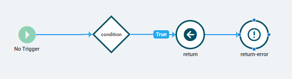

As I mentioned, another example would be Dataset_hasChanges.
Why is there a call to the return-error following the call to the return ?
My ASSUMPTION of the event-row-disable action is that it is freezing any dataview CHANGE events for that dataview.
For example, there could be row-change events on OrderHed which cause other things to happen. But when you’re creating a new order, you don’t want all of those other events to fire.
So, they put in an event-row-disable action (disabling row action events on OrderHed)… do a bunch more stuff to create the new OrderHed row… then call the event-row-enable action (to turn those row change events back on).
Again, this is only my assumption. Haven’t really experimented with this.
