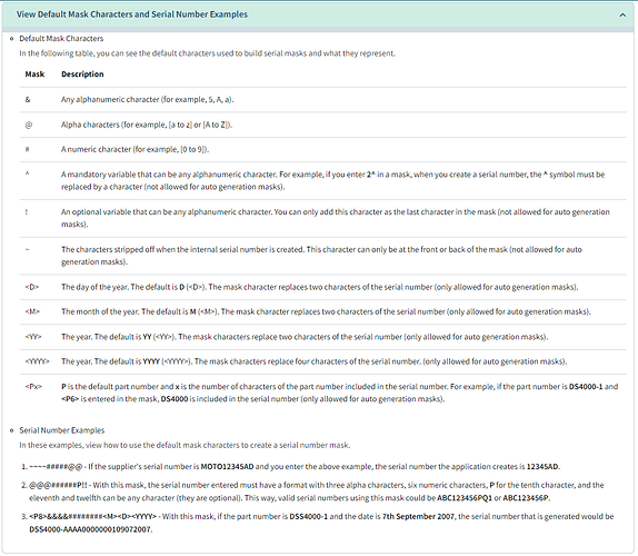

Since V8, I have used date logic. From the help:

Try changing it to:
<YY>#####
