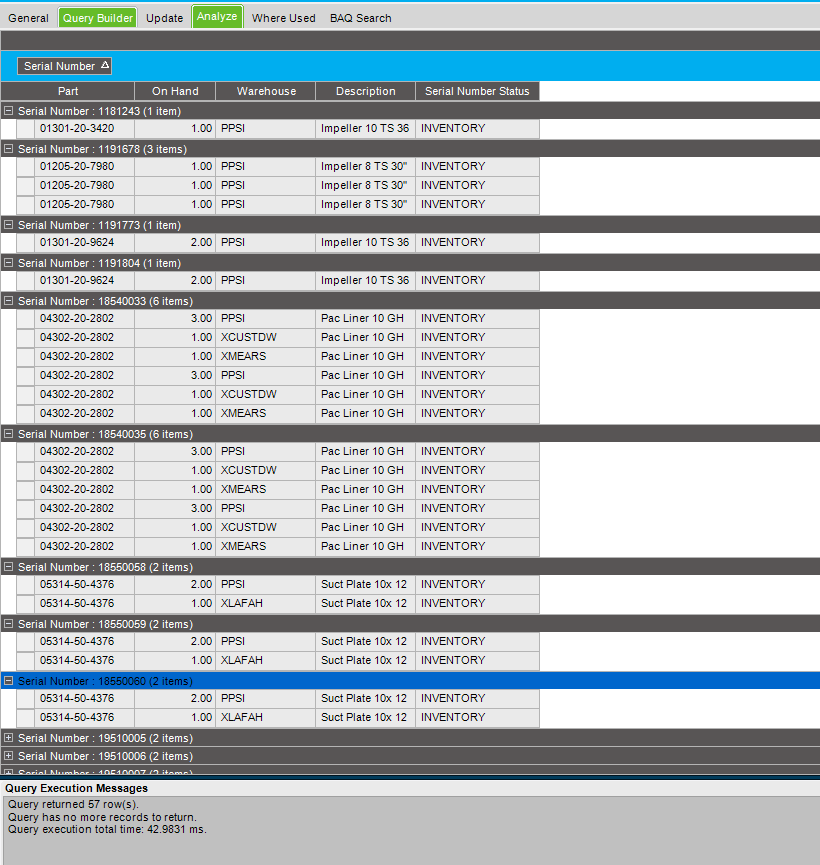

I am having trouble with duplicate serial numbers in a BAQ I am running. In an instance where a serial number cannot repeat on a specific part they are showing up multiple times. Is there a criteria or something I can add to stop these duplicates from populating.

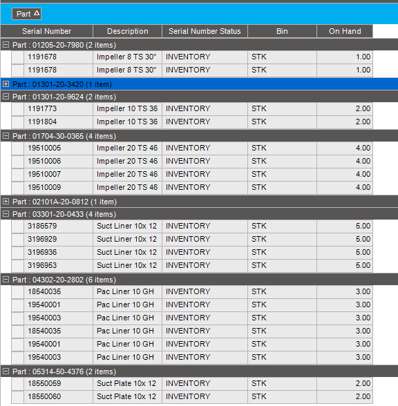

I got it closer to having no duplicates, but what i dont understand is why are the duplicates so inconsistently wrong? One part has a qty of 4 and 4 serial numbers. Another part has 3 in stock with 3 serial numbers, but shows all 3 records twice. Another part has 1 in stock but shows 2 records for the same serial number.

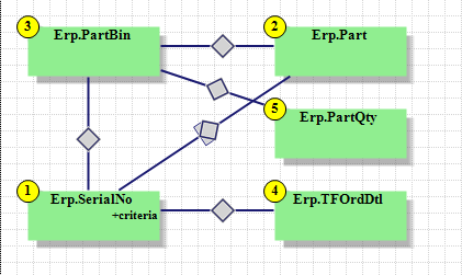

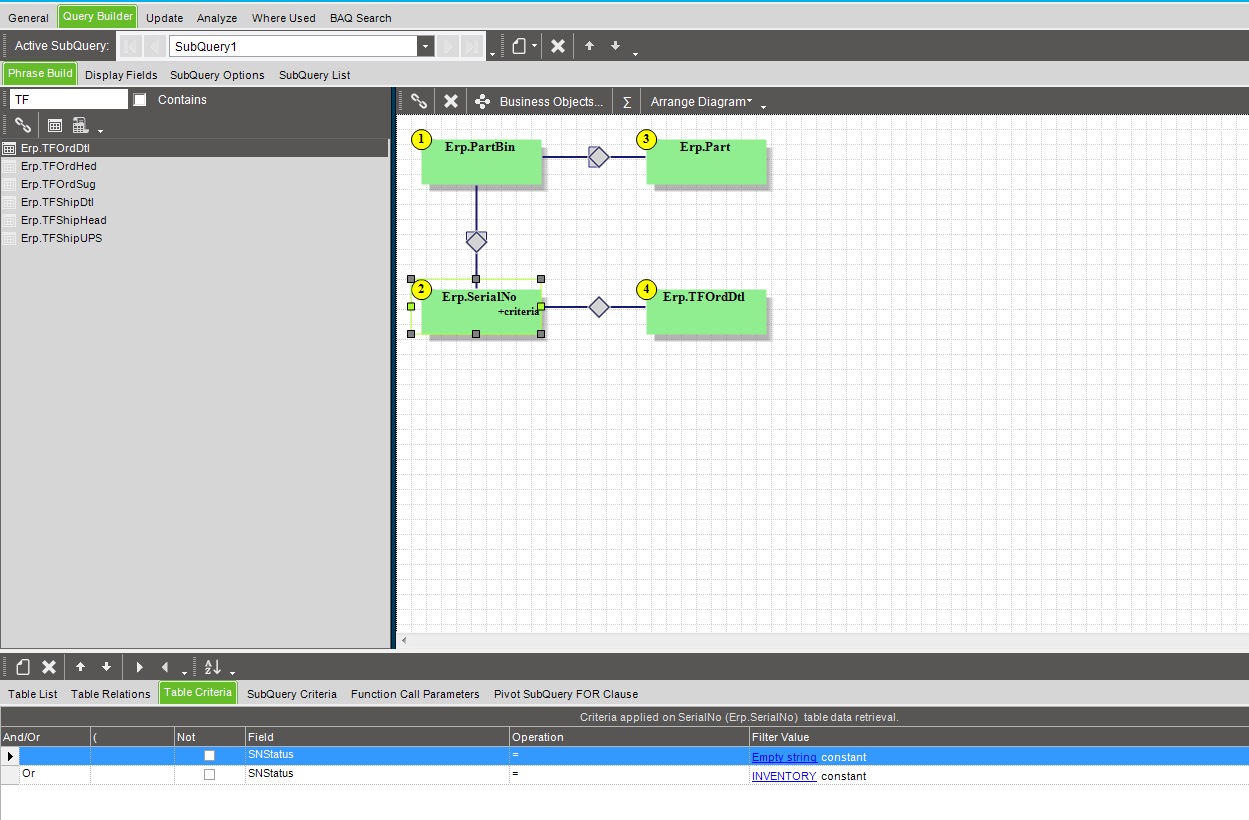

I am attaching my most recent iteration of the joins I have put together. I don’t particularly know what left outer join and inner join mean, but this is how I have gotten the least number of duplicates. TFOrdDtl just being attached reduces duplicate records by a great amount. If you have a better suggestions for how to accomplish this I would be glad to give it a shot.QueryBuild

An inner join is when where there are matching records from both sides tables. A left or right join returns records from one table and the matching rows from the other. It looks like you fixed the initial issue, but now you’ve created another problem by creating a circular join between the part, partbin, and SerialNo tables. This will not produce a valid dataset.
The joins on the TFOrdDtl table don’t really relate to the serial numbers at all, so it should proabably be removed from your query altogether.
You should be able to produce a full inventory list from just the PartBin table.
